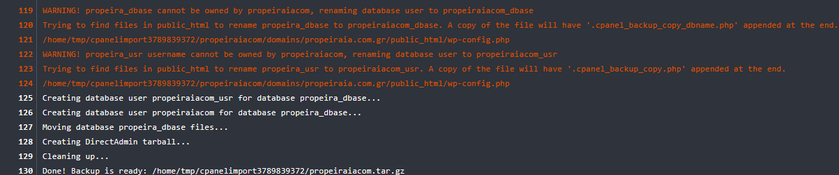

I am making several transfers from a cpanel account to my DA server and I get the known issue different username/database username found here:
Do you know how to change ignore errors variable to yes so that I can complete the transfer and then change the database username?

Yes you are right about that but yet the user is not created and the cpanel import is aborted. :confused:
Yes of course.
As you said this is a warning but the script ends in line 130.
In the successfully completed imports after the line "Done! Backup is ready:" the script continues to the user creation etc.
Whenever I get these warnings, the script can't continue to user creation.
Like in this example the username of the user in cpanel is propeiraiacom with db username propeira_dbase.
Would it be safe to change the username in cpanel to be the same as the database username?
Meaning to change the cpanel user from propeiraiacom to propeira?
Also shouldn't I be able to change somehow these variables(Ignore Errors, Replace Users) for each cpanel import?

I have attached the whole log file from this cpanel import that failed to complete if this helps.
