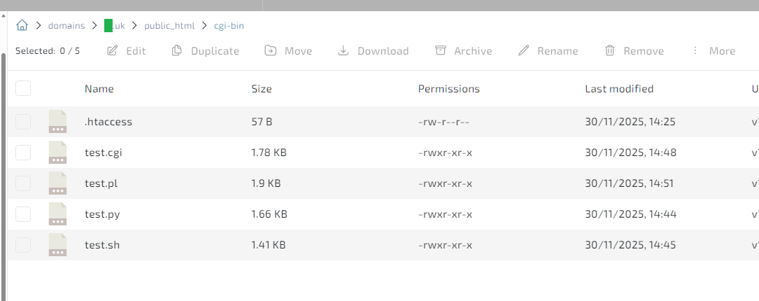

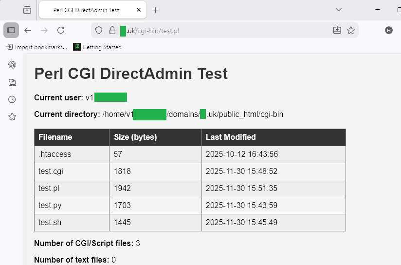

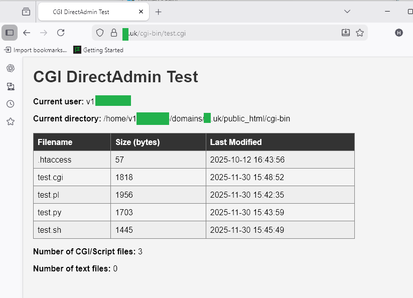

The httpd.conf file, mine works without any changes. (Running Apache)
With the .htaccess, mine reads;
Options -Indexes +ExecCGI
AddHandler cgi-script .cgi .pl .py
Have you set correct permissions for the CGI script? Should be 755, not 644.
Scripts available on request to test CGI compatibility. Thought i'd mention 😶🤣🤣
