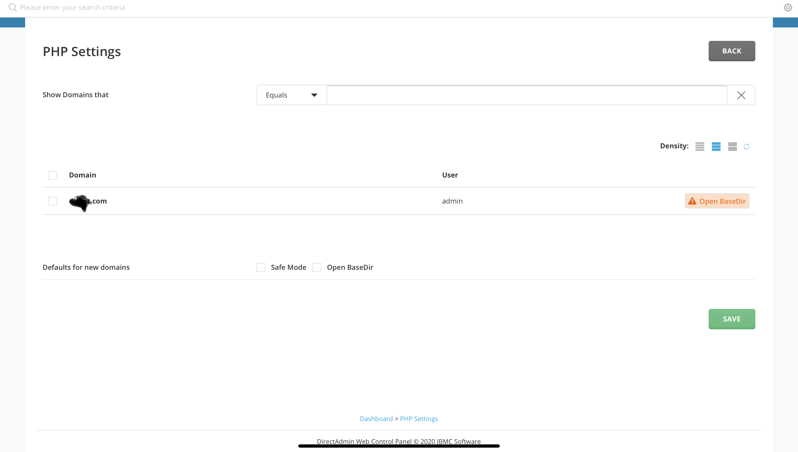

How to turn of Open BaseDir?
tomwin
Apr 23, 2020
77
On my picture it look strange, with a warning sign. Is it turn of when it looks like that?
Are there any more places I need to check?
You are in the correct spot it appears.
select the check box by the domain
PHP Settings
You can also want to enable/disable Open Basedir in some of your client(s) site(s). In order to do so, click on the "PHP Configuration" in "Server Manager". You will see a table of all existing domains and Open BaseDir status next to them. In order to change Open BaseDir status. select desired domains and click on "Enable/Disable Open BaseDir" button.
