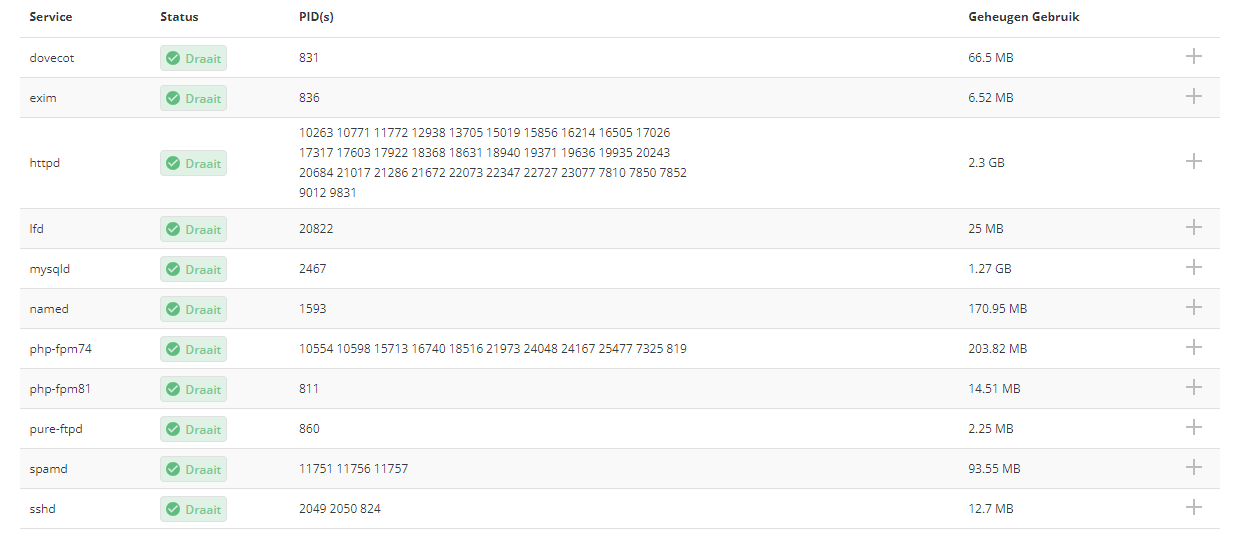

We just notice that the HTTPD increases enormously and this causes the problem that the websites go down.
Here is a screenshot of the consumption. According to my colleague, we cannot increase this limit because it has been fixed. Or is it possible to give freedom in this?
you need to check not service monitor but Process Monitor (top), of after overload usually DA send you notification with all processes running and IPs connected. You can check this letter on admin level or on your email if you configured to send you copy of such notifications
I think, maybe when your website go down, apache will generate logs like this
scoreboard is full, not at MaxRequestWorkers.Increase ServerLimit." ? .
Next time, when go down, go check log in "/var/log/httpd/"
