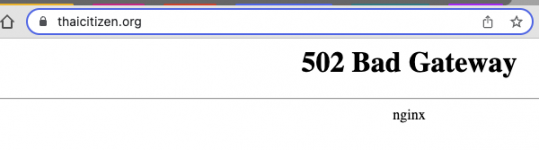

I am very new to all of these... Usually, we develop using WordPress or PHP but now we started using nodeJS which requires deploying apps and running a node server on a port. So instead of only nginx we switched to apache_nginx because there are many accounts that still need .htaccess files. Apparently only using apache for Node isn't recommended. It was quite hard to get it to work because almost all tutorials out there are made for centos, apache, or Nginx on a non-shared server without an admin panel.
So, finally figured out that we need to use those "tokens" to make changes to nginx_apache configuration files. Our app is running on port 3000 and forwarding 8080 to 3000 works. But not secure. Forwarding 8081 to 3000 we get a bad gateway even though the app server is running (however, the site looks secure, as SSL is active).
With custom code, nginx.conf file for thaicitizen.org file looks like this:

There are also these templates there you can see, but I'm not sure if I should be editing those and how?
I deployed some sample code to a domain we don't use to take some screenshots, have a look, please. What am I doing wrong here? Thanks in advance...

one more thing to check, Possible CSF Firewall blocked outgoing port :3000 ? try allow port to csf firewall.
