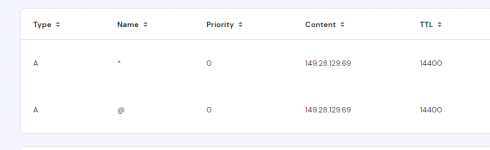

Godaddy helped me for this bu they have added server.example.com in hosts like below screenhost, is it will work
Yes that is good. Seems they might use the name "server" for the rDNS record.

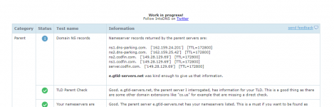

your NS settings are messed up:
Name Servers Have A Records
FAIL: While reading domain NS records at parent name servers, we found name servers without A records.
    ns1.codfin.com. → ?
  • United States
    ns1.dns-parking.com. → 162.159.24.201
    ns2.codfin.com. → ?
  • United States
    ns2.dns-parking.com. → 162.159.25.42
  • United States
    server.codfin.com. → 149.28.129.69
To reach your name servers via IPv4 an A record is needed for each name server.
