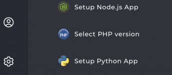

I think before you maybe had a Cloudlinux environment which has the "Setup Python App" feature in DirectAdmin.
Not exactly, I watched a Youtube video that had it, and the person called it Directadmin, and it also looks like my Directadmin interface
Ah ok.
Cloudlinux has it, which is easy yes.
Looks like this :) It is chill. But the nginx unit works also good. Needs a bit more config also for the routes.
Yes that is correct, it's present in the modern licenses, but not in legacy, so not any lifetime which are mostly provided by datacenters like in this case. That's legacy and doesn't have that option build in.
Ah ok.
Thank you very much, I will consider my options of either changing to Cloudlinux or using nginx unit
Thank you very much Richard, now I know
