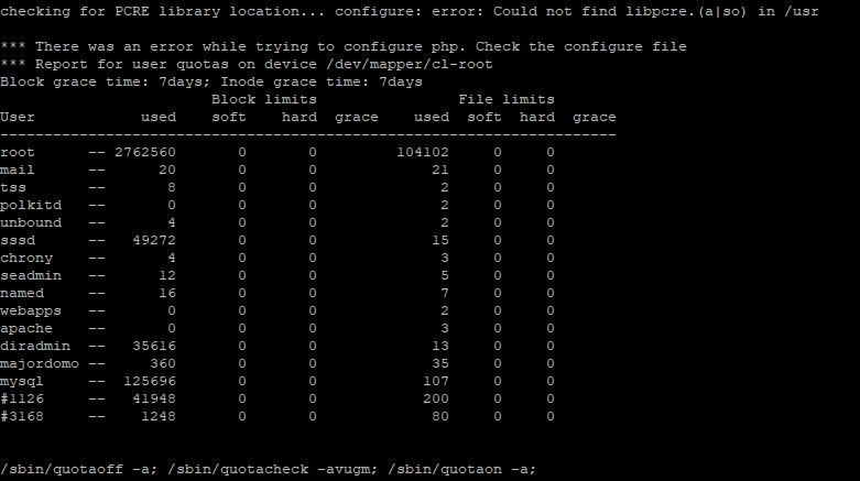

I'm just starting out, and when I started installing the DA, it crashed. You help me

May you try:
/usr/local/directadmin/custombuild/build update
This should solve it, there was a bug with end-of-life versions of PHP on new installations.

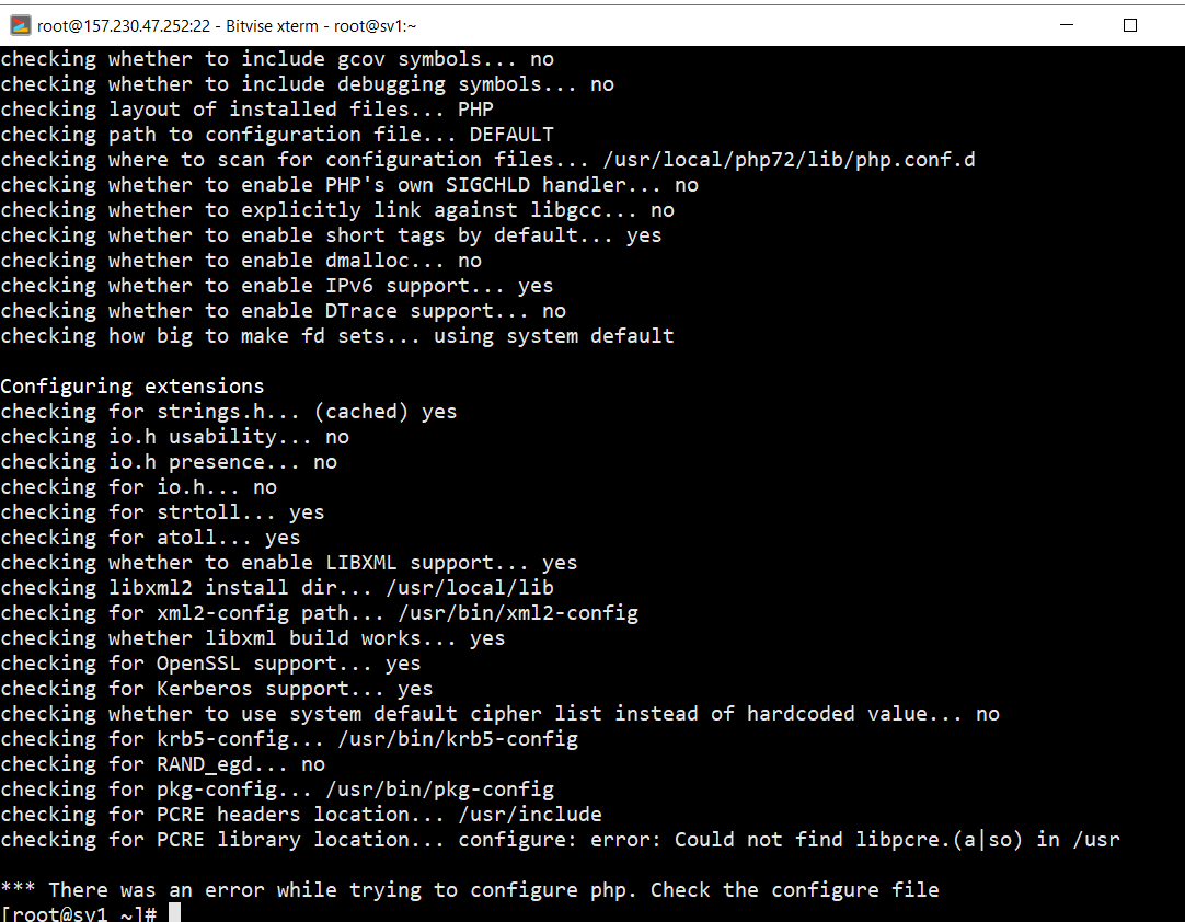

I have the same problem in both CentOS 7 & 8 but have more errors :
Please help.
