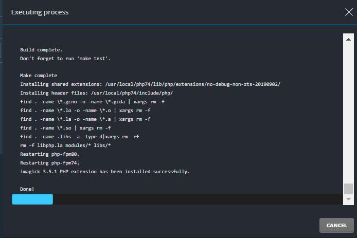

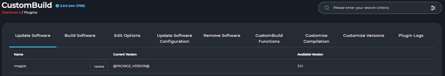

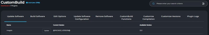

After installing Directadmin with PHP8.0 as the first PHP version, and PHP7.4 as the second ( then install imagick through custombuild). Then I got the following notification with no information about the current version:
It looks like imagick was loaded successfully:
When I click update, it will reinstall with no error
But still got the same notification from custombuild to update
root@sun:~# php -m | grep imagick
imagick
