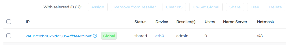

As admin I've these settings:
But I can't figure out how to get the IP6 to resellers and individual domains.
