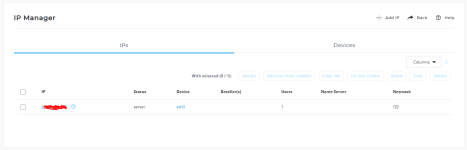

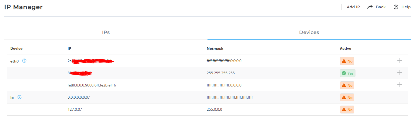

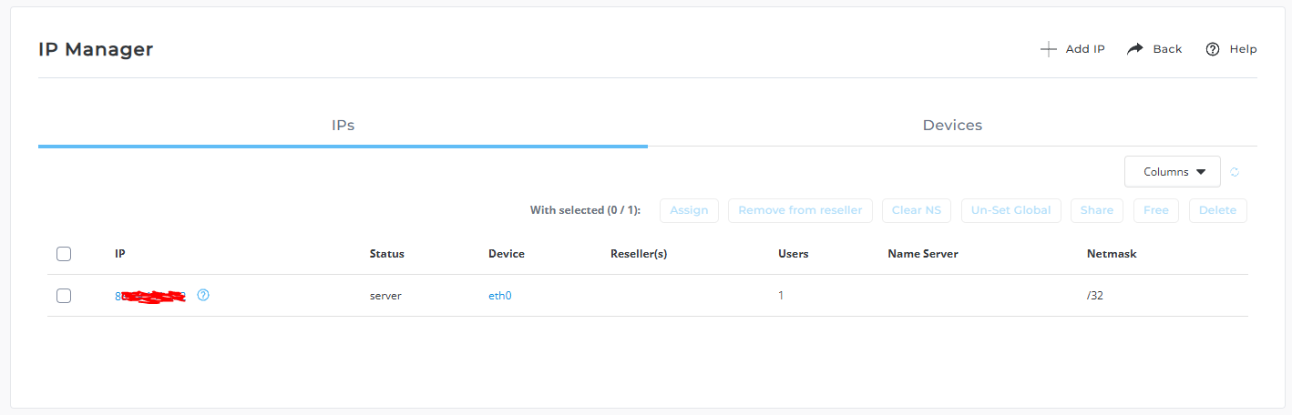

Here is how the IPs and Devices tabs look like in IP Management section . See attached pictures .
I don't think anything is wrong with that . The only 127.0.0.1 I edited was one to bind mysql to local connections . Can't recall using that anywhere else .
