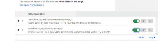

I have had problems with CloudFlare and Letsencrypt, found I needed to add a Rule like this on CloudFlare to make it work properly to issue local certificates for domains:
*yourdomain.com/.well-known/acme-challenge/*
Cache Level: Bypass, Automatic HTTPS Rewrites: Off, Disable Performance
I used to do that till I added a rule to CF to allow the acme-challenge through without caching it, and haven't had any issues for almost two years.
Yours would look like this in CF control panel, the asterisks are required.
*radzikow.ski/.well-known/acme-challenge/*
Cache Level: Bypass
Disable Performance
https://prnt.sc/1rliokw i have these rules set - still erorr - also on facebook group that i run there was 2 reports on DA users (not on my VPS) with exactly the same error - none of them use Cloudflare

pic is from cloudflare settings - for me solution above didnt work ;/
