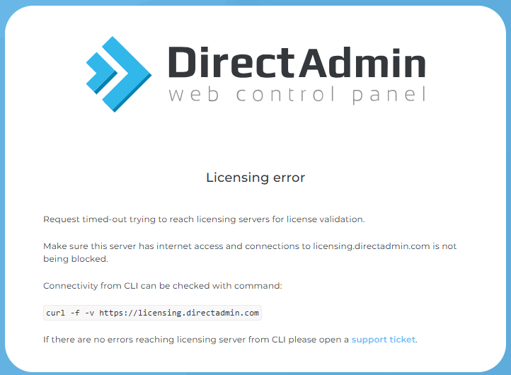

I am having this problem at different intervals. Each time it was solved as advised, by curl -f -v.....etc.
This time does not work. I opened a ticket, no reply yet. License is valid until Sep. 2025.
This is not new install, it was working for a year or so without issues.
Anybody knows a solution please?
Thanks in advance.
