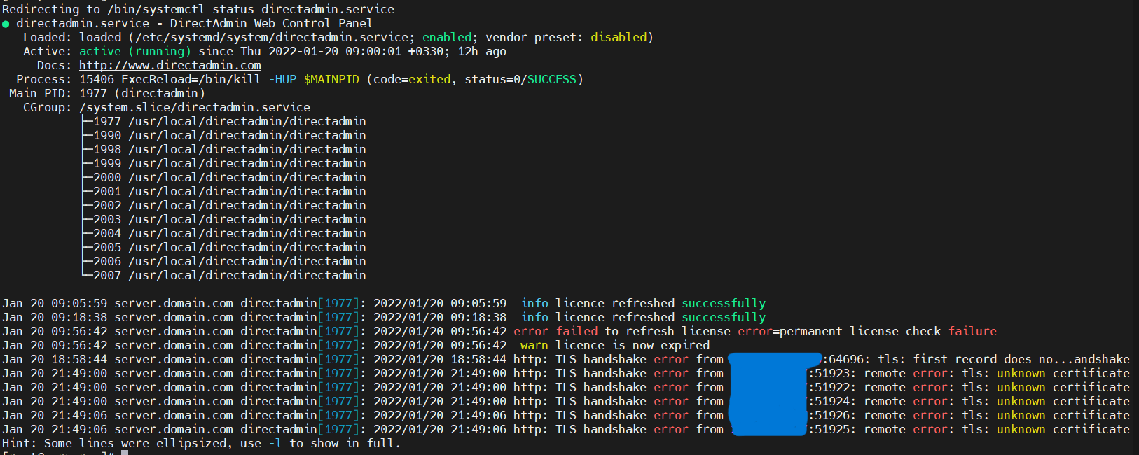

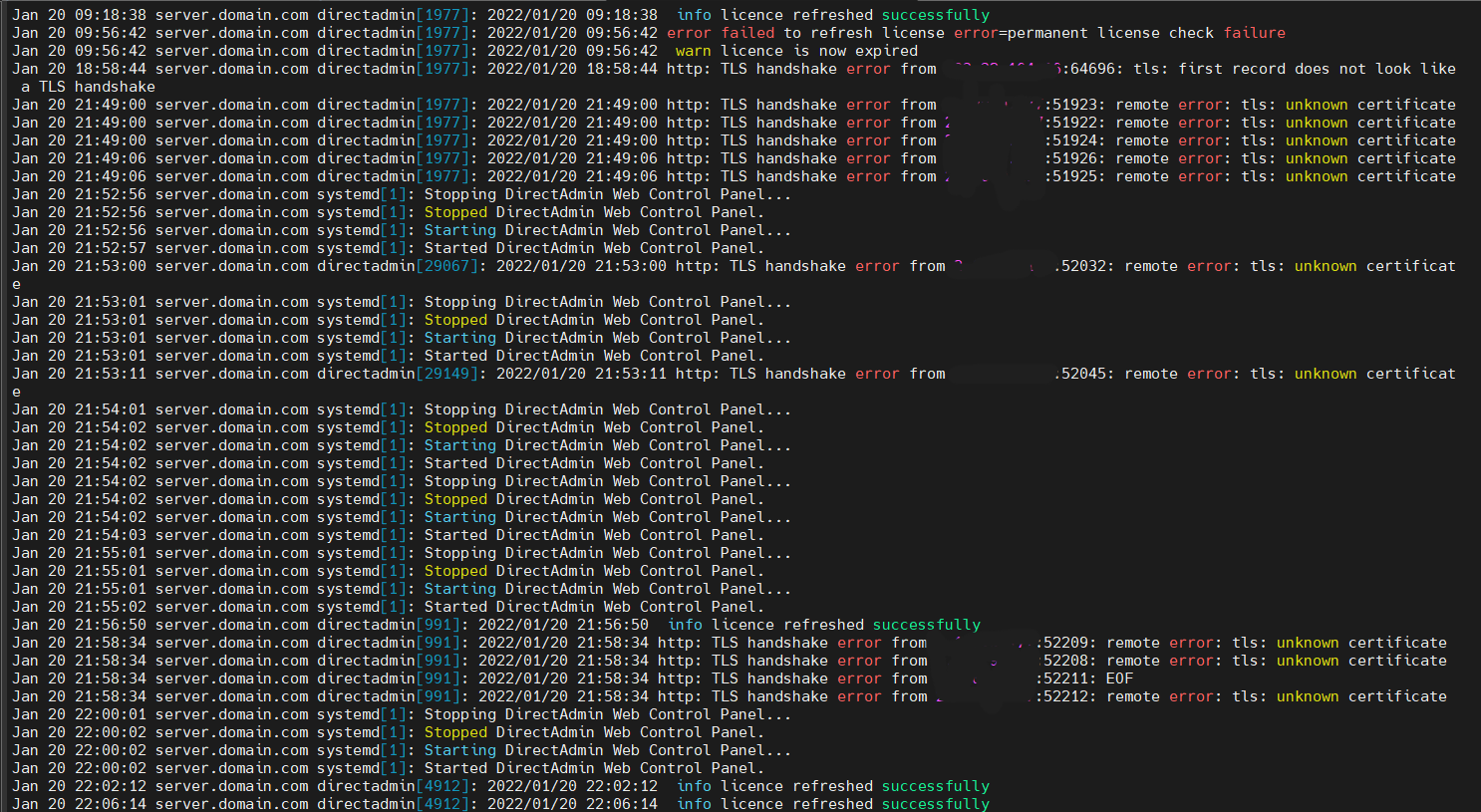

A couple things. Could you please post your license ID#? There is no risk in this. Don't post the key, however. Just the license ID#.
Can you also give the output of:
journalctl -u directadmin -n 100 --no-pager
The output of the command order is presented in the appendix:
Based on the error log I think the problem is caused by using same license on multiple servers. Please make sure you are not using same license twice.
If you would fill a ticket in our support system we would be able to assist you further and provide more information on what other servers are using your license.
