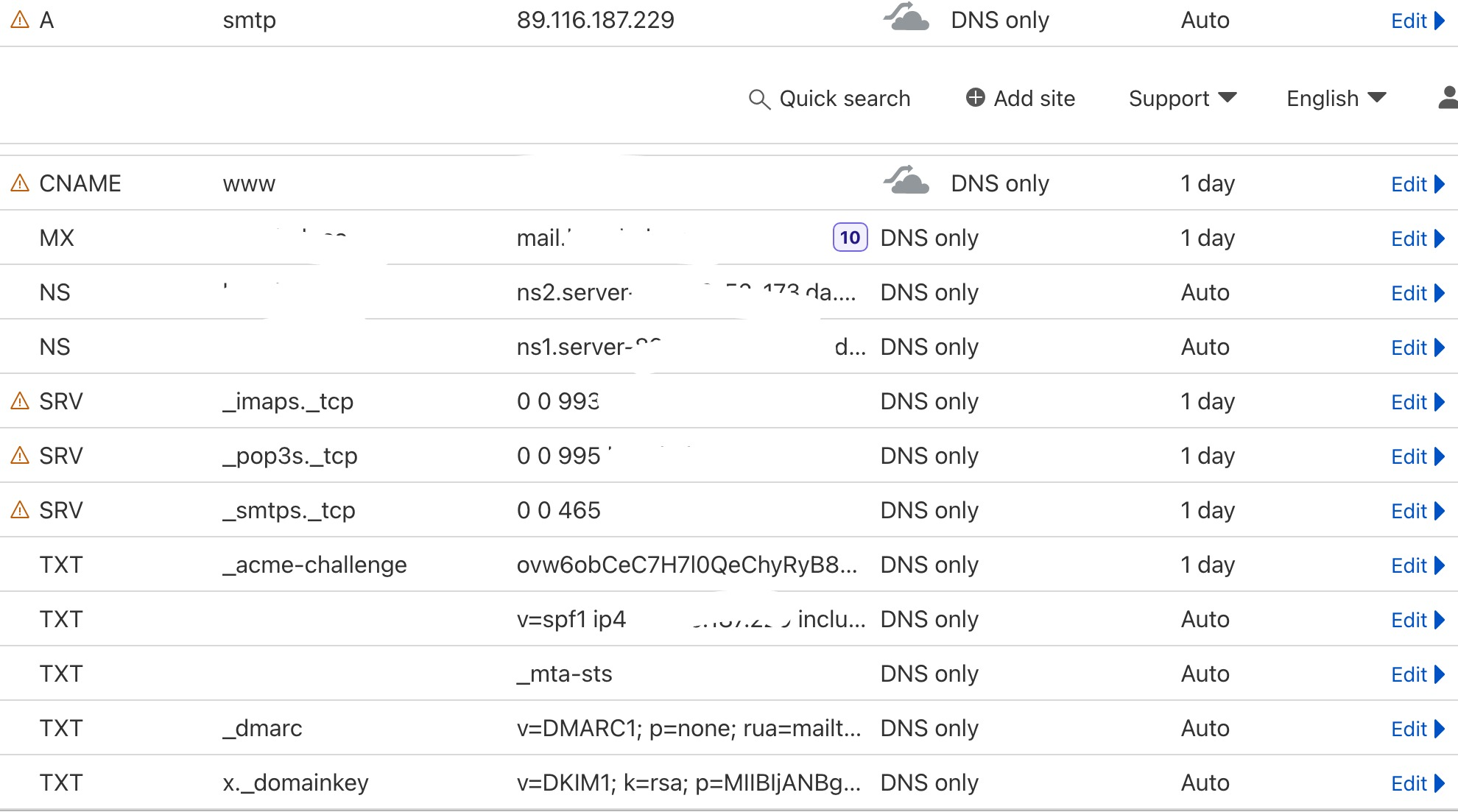

Mail Server Can’t send to gmail (only Gmail)
yuttakarn
Apr 11, 2024
9
Screenshot_11-4-2024_13634_dash.cloudflare.com
Screenshot_11-4-2024_13634_dash.cloudflare.com1930×970 186 KB
Status: 5.0.0
Remote-MTA: dns; gmail-smtp-in.l.google.com
Diagnostic-Code: smtp; 550-5.7.1 The IP you’re using to send mail is not
550-5.7.1 authorized to send email directly to our servers. Please use the SMTP
550-5.7.1 relay at your service provider instead. For more information, go to
550 5.7.1 'The IP you're using to send email is not authorized...' - Gmail Help 17-20020a630c51000000s9fsi610012pgm.818 - gsmtp
outlook, m365 can receive normally
Stil not working
;; A Records
domain.co. 1 IN A 89.116.s
mail.domain.co. 86400 IN A 89.1s
pop.domain.co. 1 IN A 89.116.1s
smtp.domain.co. 1 IN A 89.116.1s
webmail.domain.co. 86400 IN A 89.11s
;; CNAME Records
ftp.domain.co. 86400 IN CNAME domain.co.
www.domain.co. 86400 IN CNAME domain.co.
;; MX Records
domain.co. 86400 IN MX 10 mail.domain.co.
;; NS Records
domain.co. 1 IN NS ns2.ssss.da.direct.
domain.co. 1 IN NS ns1.server-ss.da.direct.
;; SRV Records
_imaps._tcp.domain.co. 86400 IN SRV 0 0 993 domain.co.
_pop3s._tcp.domain.co. 86400 IN SRV 0 0 995 domain.co.
_smtps._tcp.domain.co. 86400 IN SRV 0 0 465 domain.co.
;; TXT Records
_acme-challenge.domain.co. 86400 IN TXT "sssss"
domain.co. 1 IN TXT "v=spf1 a mx ip4:89.s ip6:2ss:ss:10:sss:0:0:0:1 include:_spf.google.com ~all"
domain.co. 1 IN TXT "_mta-sts"
_dmarc.domain.co. 1 IN TXT "v=DMARC1; p=none; rua=mailto:[email protected],mailto:[email protected];"
x._domainkey.domain.co. 1 IN TXT "v=DKIM1; k=rsa; p=MIIBIjANBgkqhkiG9w0BAQEFAAOCAQ8AMIIBCgKCAm/MD5iBpjDnvyBQSftcsFaOvEkP4NJo6TNkaw9sDrNJl83Fcg/fYYPuB1aZekHAd6bf7vqOQFfo06KfSLLgrtEBd" "0Xlh3TP7s/Aj6BSQrUkSqvf4sNyGdDwsEiGdJGGp9J7+CUQDuldZRyvdcjDqjn3FLllrL64m54LT7XJyuwjepEQn6IPPwcsewYTDloCq9ALsSy04mzQIDAQAB"
tip;
dont use these type of ns names:
but something like
ns1.myserver.com
ns2.myserver.com
Also change srv496654.hstgr.cloud to your own
what should i do
