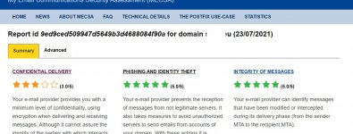

Is important to have more info about this official test!
  • TEST European Commission
  • My Email Communications Security Assessment (MECSA)
x509 Certificate
FQDN error
mx record to mail.domain.com in dns
mailsni=1
Did all rebuild rewrite and updates! latest DA exim, dovecot, custombuild gui . plugins and centos8
test to reproduce if you not use hostename in mx record but domainname here
cONFIDENTIAL DELIVERY
(3.0/5)​
Your e-mail provider provides you with a minimum level of confidentiality, using encryption when delivering and receiving messages. Although it cannot assure the identity of the parties with which interacts

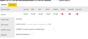

Here example where i did put in MX record the hostname.
Same mailadress / domain only change mx record from mail.domain.nl to hostname. ( on hostname itself there is no dnssec , so this is why important here)
Then the X509 error is ofcourse gone.

Just out of curiosity, the major thing I see happening is the X509 getting an exclamation mark, rest is fine.
What is the big thing about X509? Because there is also SPF, DKIM, DMARC and StartTLS.
I was just wondering because I've had a look at the competition at cPanel and they are even doing worse, getting a 2.5/5.0 and have the same X509 exclamation mark.
So it seems DA is not the only panel and I'm wondering if it's even a panel thing and curious about why the x509 is so important.
