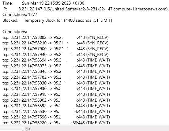

Since like a couple of weeks almost daily on at least 2 servers I get messages like below from CSF firewall.
Never had them before, but seems amazonaws ip's are using massive connections, over 1000 often, but often a lot of time_wait connections like this:
In this case 1377 connections, it's always to port 443, so one would think to a website.
But when I do a grep on the ip, I can't find anything in the syslog or httpd logs or domain logs.
In /var/log/httpd/domains I tried like cat * | grep 3.231.22.147 but nothing. Same in /var/log or /var/log/directadmin. Only in /var/log I get an output from lfd.log.
Mar 19 22:15:39 server23 lfd[30687]: (CT) IP 3.231.22.147 (US/United States/ec2-3-231-22-147.compute-1.amazonaws.com) found to have 1377 connections - *Blocked in csf* for 14400 secs [CT_LIMIT]
It seems only the firewall sees this and blocks this, so I don't know where this is going.
And this is multiple times a day and from multiple amazonews ip addresses.
Now I can disable these mails, but amazonaws is the only one causing these, so this seems not right. I can't fill in an abuse report, because they want a piece of the according log, which I don't have, because I can't find anything.
Does anyone have an idea where to look for?

I've seldom seen any ip's getting over the ct_limits. I might indeed try to block them at the datacenter router for 30 days. Just wondering if they just won't use other ip addresses as I now already have seen around 8 of them.
Can this use resources like a ddos?
Or can I just set the CT_SKIP_TIME_WAIT = "0" to 1 to ignore the time_wait which are the most connections and forget about it if it's not coming back with other states?

@pat0 Hmmz... most likely these can not be reported... this is from the reporting policy of abuseipdb.
Report MUST NOT be of an attack where the source address is likely spoofed i.e. SYN floods and UDP floods. TCP connections can only be reported if they complete the three-way handshake.
And in fact as far as I can see, due to the fact that it's only SYN_RECV and TIME_WAIT in the CSF mails, it seems syn flood to me, so not allowed to be reported. :(
Or am I mistaken?
