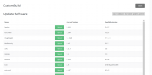

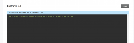

F fabioweb90 Verified User Joined Feb 20, 2022 Messages 41 Jul 26, 2023 #1 Hello, as you can see i need to update my server but i have the following message. Which steps i have to do? Thanks Attachments 1690410755760.png 243.1 KB · Views: 44
Richard G Verified User Joined Jul 6, 2008 Messages 14,865 Location Maastricht Jul 26, 2023 #2 You can follow this guide, best is to login via SSH as root. PHP | Directadmin Docs DirectAdmin Knowledge Base docs.directadmin.com
