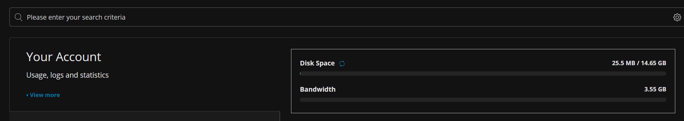

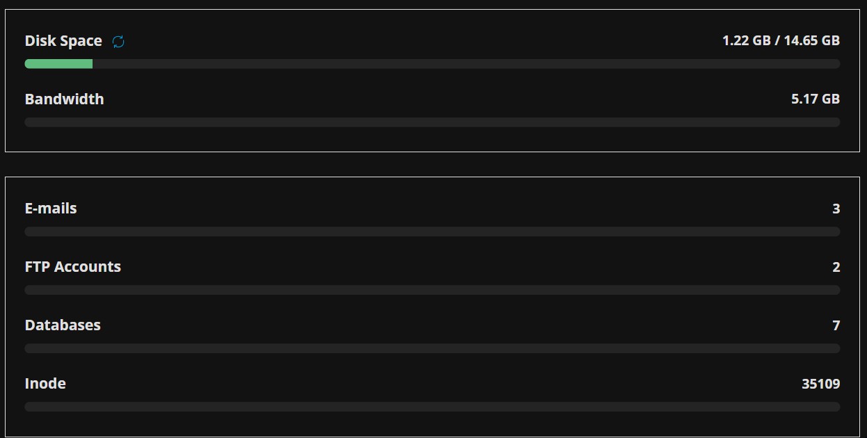

When I go to the main window, DA shows me that I've only used 25MB of disk space

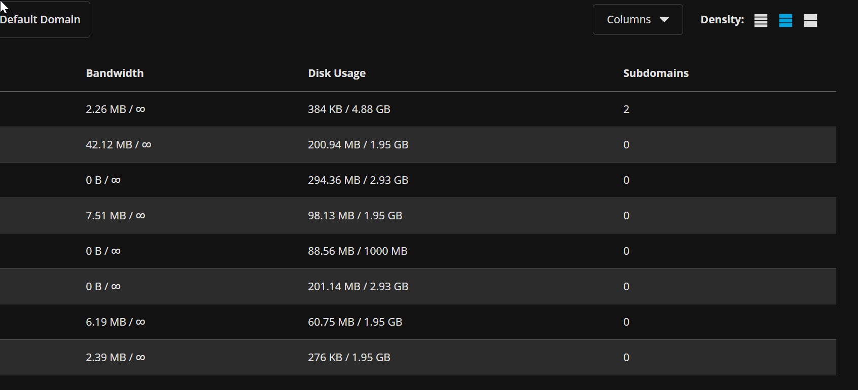

When I go to Domain Setup, it shows data correctly. The cron job runs correctly at 00:10 every day

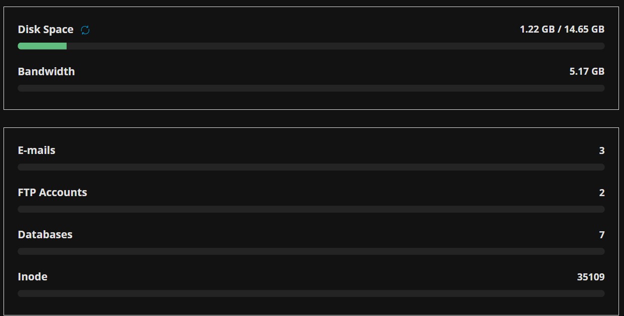

It looks like this widget doesn't count FTP data at all, it only counts databases and e-mails. The transfer is also weird. DA is fresh installed and has very low traffic.
There is no database, email, or ftp data in your screen shot so its hard to know anything.

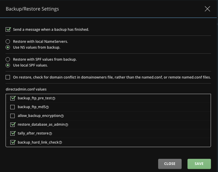

Also when you restored did you mark Tally After Restore. https://www.directadmin.com/features.php?id=853

I have the same issue. It's not updating in any way in enhanced skin.
Seems more people are experiencing this. Have seen a couple of posts about it.
I think you just have quotas not enabled on the system/partition.

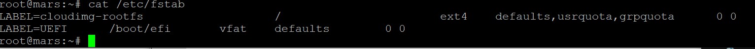

My /etc/fstab looks like that:

According to link, everything is alright (or maybe I'm wrong? I could use some constructive criticism). Then I got to this: https://help.directadmin.com/item.php?id=222

@FatBob try executing repquota /, does it show the usage? /etc/fstab just shows what should be set, but not what is actually set there, execute mount and check if quota options are specified for /.

repquota /
*** Report for user quotas on device /dev/sda1
Block grace time: 7days; Inode grace time: 7days
Block limits File limits
User used soft hard grace used soft hard grace
root -- 3722840 0 0 126053 0 0
daemon -- 68 0 0 4 0 0
man -- 2172 0 0 156 0 0
mail -- 7428 0 0 264 0 0
systemd-timesync -- 4 0 0 2 0 0
syslog -- 52692 0 0 21 0 0
_apt -- 24 0 0 4 0 0
tss -- 4 0 0 1 0 0
landscape -- 8 0 0 3 0 0
pollinate -- 4 0 0 2 0 0
ubuntu -- 52 0 0 16 0 0
bind -- 38192 0 0 5 0 0
apache -- 28596 0 0 3268 0 0
diradmin -- 53288 0 0 1774 0 0
majordomo -- 440 0 0 49 0 0
webapps -- 92668 0 0 7386 0 0
mysql -- 1807732 0 0 1024 0 0
cb_plugin -- 4888 0 0 40 0 0
admin -- 1242180 15360000 16896000 35109 0 0
lsadm -- 340 0 0 147 0 0
#62803 -- 476 0 0 4 0 0
mount | grep ' / '
/dev/sda1 on / type ext4 (rw,relatime,quota,usrquota,grpquota)
realtime_quota=0 Tried to set 2 but it doesn't take. https://docs.directadmin.com/directadmin/general-usage/disk-usage-bandwidth/

What is making you think the FTP data is wrong? The screen shot is of the number of ftp and email accounts. Is the 1.2 GB not correct?
