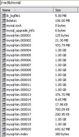

I have a problem with var/lib/mysql/mysql-bin.0000xx file size is larg and many. like picture below
How can I reduce file size or can I delete some file from here.

If you do not want to log bin, then edit /etc/my.cnf and remove log-bin line from it (or comment it out), restart MySQL afterwards.
It's recommended to use RESET MASTER or PURGE MASTER LOGS to remove them (but it should have no problems with a simple rm if you have no replication set up):
http://dev.mysql.com/doc/refman/5.1/en/binary-log.html

Yes, it's a correct way to disable it. And it should have no problems after "rm /var/lib/mysql/mysql-bin.0000??" if you are not using replication.
