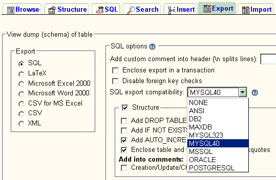

I have check the phpmyadmin but I don't see any information about export to 4.0 :( :(
I think thay use old version of phpmyadmin
try install phpmyadmin 2.7.0 or higher on cpanel and dump it
package form da should also usable
http://files.directadmin.com/services/9.0/
(also use config.inc.php from da server)
Thank you for your message...
I was try it, download the backup file in MYSQL40 version...I was successfuly upload the SQL file on mySQL 4.0.x but the Turkish characters is ruined now... :( :(
