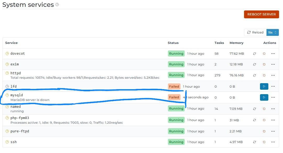

mysqld / MariaDB server is down. Got error when turn it on again. How to fix?
Horse
Aug 23, 2020
13
System services screenshot :
Try click restart button, got this error message :
Failed to start service
Try run this command on ssh, here is the result:

systemctl start mysqld
systemctl status mysqld -l
I am the one who need to say thank you :)👍
Here is the result, looks like still same?
root@server1:~# mv /var/lib/mysql/aria_log_control /var/lib/mysql/aria_log_control.orig
root@server1:~# systemctl start mysqld
Job for mysqld.service failed because the control process exited with error code.
See "systemctl status mysqld.service" and "journalctl -xeu mysqld.service" for details.
root@server1:~# systemctl status mysqld -l
× mysqld.service - MySQL database server
Loaded: loaded (/etc/systemd/system/mysqld.service; enabled; preset: enabled)
Active: failed (Result: exit-code) since Thu 2026-02-26 22:22:29 WIB; 12s ago
Process: 27614 ExecStartPre=/bin/sh -c systemctl unset-environment _WSREP_START_POSITION (co>
Process: 27617 ExecStartPre=/bin/sh -c [ ! -e /usr/local/mysql/bin/galera_recovery ] && VAR=>
Process: 27637 ExecStart=/usr/local/mysql/bin/mysqld $MYSQLD_OPTS $_WSREP_NEW_CLUSTER $_WSRE>
Main PID: 27637 (code=exited, status=1/FAILURE)
Status: "MariaDB server is down"
CPU: 224ms
Feb 26 22:22:29 server1 mysqld[27637]: 2026-02-26 22:22:29 0 [Note] InnoDB: Starting shutdown...
Feb 26 22:22:29 server1 mysqld[27637]: 2026-02-26 22:22:29 0 [Note] InnoDB: Removed temporary ta>
Feb 26 22:22:29 server1 mysqld[27637]: 2026-02-26 22:22:29 0 [ERROR] Plugin 'InnoDB' registratio>
Feb 26 22:22:29 server1 mysqld[27637]: 2026-02-26 22:22:29 0 [Note] Plugin 'FEEDBACK' is disable>
Feb 26 22:22:29 server1 mysqld[27637]: 2026-02-26 22:22:29 0 [ERROR] Could not open mysql.plugin>
Feb 26 22:22:29 server1 mysqld[27637]: 2026-02-26 22:22:29 0 [ERROR] Failed to initialize plugin>
Feb 26 22:22:29 server1 mysqld[27637]: 2026-02-26 22:22:29 0 [ERROR] Aborting
Feb 26 22:22:29 server1 systemd[1]: mysqld.service: Main process exited, code=exited, status=1/F>
Feb 26 22:22:29 server1 systemd[1]: mysqld.service: Failed with result 'exit-code'.
Feb 26 22:22:29 server1 systemd[1]: Failed to start mysqld.service - MySQL database server.
lines 1-20/20 (END)
Let me know if there i can try again
Thank you before 🙏
Look like too much broken, I have no idea to recovery this broken anymore.
Do you have any Admin Backup files ? we just need to clean re-install mariadb.
If you want to recovery the old data, I suggest hire professional skill team.
#move or remove "/var/lib/mysql" to force re-install mariadb.
mv /var/lib/mysql /var/lib/mysql_old
da build mariadb
and then restore data from the Admin Backup.
Good night.
