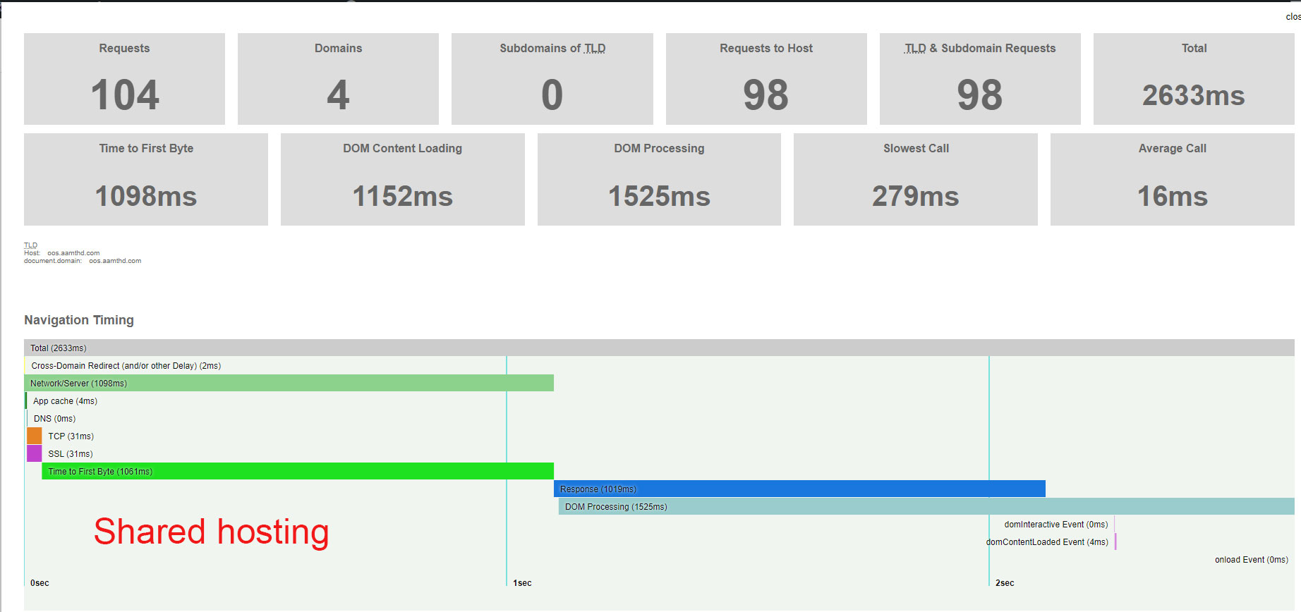

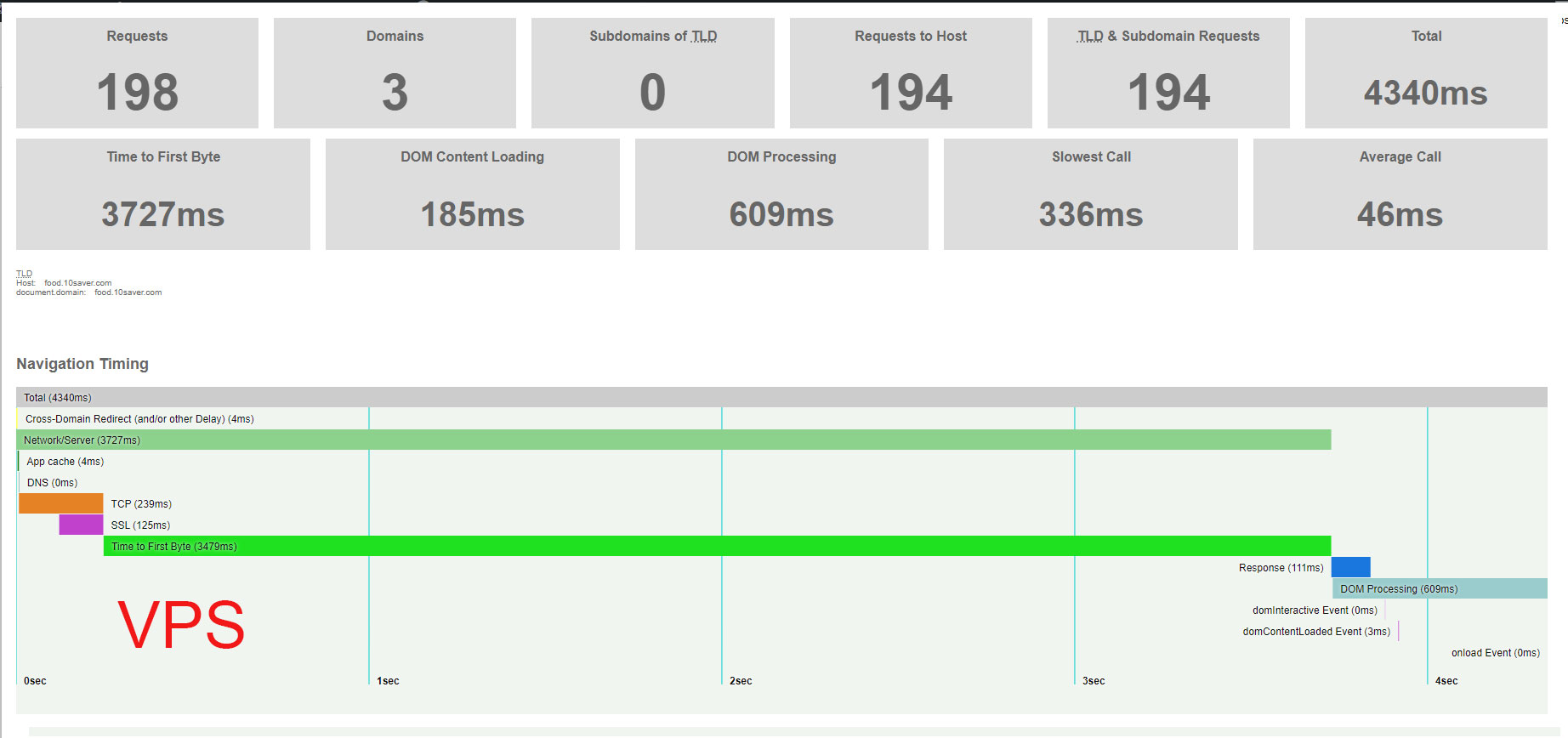

Currently, my main concern is the website's speed; it's significantly slower than my previous one, which was hosted on shared hosting. Please take a look at the attached screenshot.
I contacted the hosting provider, and they attempted to assist by installing some caching plugins to improve speed, but unfortunately, there was no improvement at all.
Could this sluggishness be due to the server, given that it's a budget hosting option at $21 per month?
Could anyone suggest ways to enhance the speed, please?

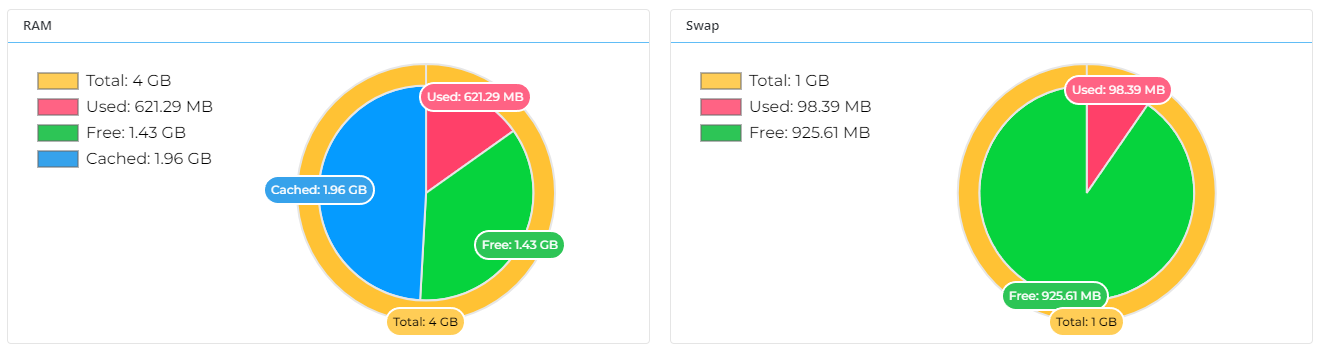

7.) It's a manage VPS, but did they create a swap space/partition and if yes how big? Because often they think "it's not needed" but in fact there are things which don't work as good as should be if it's not present. And especially with 4 GB RAM I would advise to have at least 2 GB swap.

Thank you Rchard, yes there is 1gb swap but it is hardly any used.
The screenshots are useless without knowing the background. Time to first byte is a very unclear measure, there are too many things that can influence it: dns resolving, network speed and connectivity, server load and etc.
A shared hosting server might be a server with multi cores and 512GB RAM, running on NVMe disks and having a MySQL cluster. While for a VPS you've got what you have. It would be wrong thinking a VPS will necessary make your site running faster. This is a myth. Using VPS you might have more security and more resources. But it does not necessary guarantee a speed.
If you want to identify a bottle neck, then first of all you should compare how fast your server responds when you request a static file (HTML, JPG, CSS), then you check how fast you get a simple PHP script without SQL queries, and then you compare a response time from a WordPress site. And as soon as you have the 3 measures then you have a clue on where to dig further.
It is a bad idea to try and improve every single thing hoping it will make SQL queries with a lot of joins from tables with thousands items to work faster. I know my reply does not give direct steps on how to make the server to work faster. But nobody here can give them. All we can is to guess and offer things that helped us or other guys in the past.
I believe you should change your server provider or cancel their support plan. If you ordered a managed server and then tried to make the things by yourself, probably you've picked up a wrong hosting package. Of course a list of included works might differ, but still.
These are my thoughts, and I might sound not popular. But it will be at least my honest reply: there is no a magic pill.

Caching plugins from wordpress might give no positive effect, if your pages use sessions and cookies. Such pages will most likely have a no-cache header, and skip caching.
And if your server CPU is overloaded, you will get slow pages load and too big TTFB.
So, again. We don't know your setup. And in order to help you, we need more details and information. There is still not a magic pill :cool:
