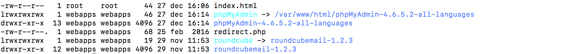

I don't know exactly when this problem has started but my users cannot access phpmyadmin and roundcube through domain.ext/phpmyadmin and domain.ext/roundcube. They get an 403 error. (You don't have permission to access /phpmyadmin on this server). Before this worked fine. I have been searching the web and have read some things about permission on (and in) the /var/www/html folder (should be root:root ?) Please see the image link below for the permissions. Because the post I read on other sites are so old I thought I better ask it here.

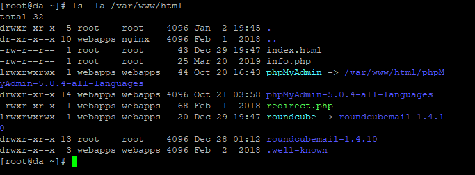

Please let us know the output of:
ls -la /var/www/html
"Symbolic link not allowed or link target not accessible: /var/www/html/roundcube"
sure. atthached

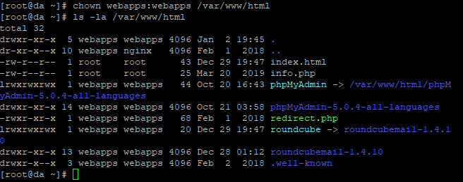

For some reason your roundcube folder is owned by root. Try resetting permissions to webapps.

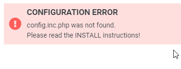

done. after that it show attached error.
Can you build again and see if that spews errors?
