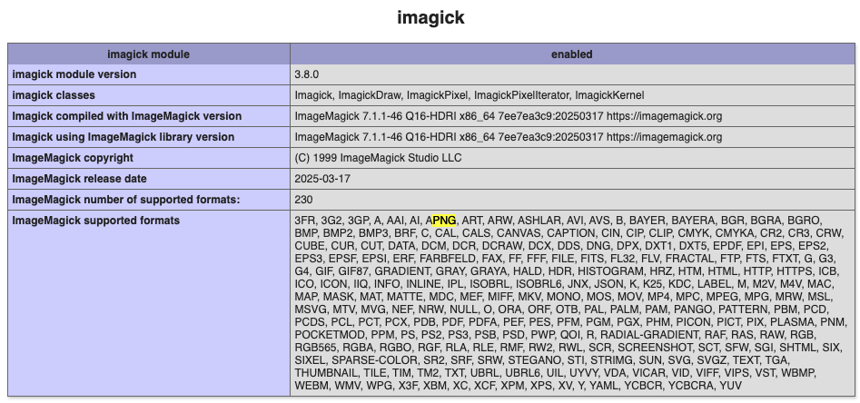

Something seems askew, because Imagick is not showing PNG as a supported type. Everything was working until I built a new DA server, including using CB to build imagick.
Trying to utilise it within PHP, and I get a fatal error.
Any ideas where to look?
ImageMagick now compilled from OS packages so you can recompile it with needed formats then rebuild php-imagick with custombuild
Thanks! I assumed it was compiled and built custombuild, not just the php module. My mistake. Thanks for pointing me in the right direction!
