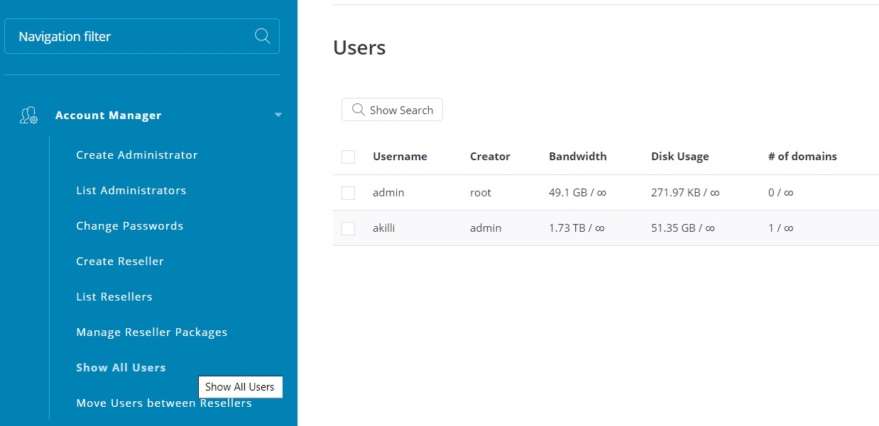

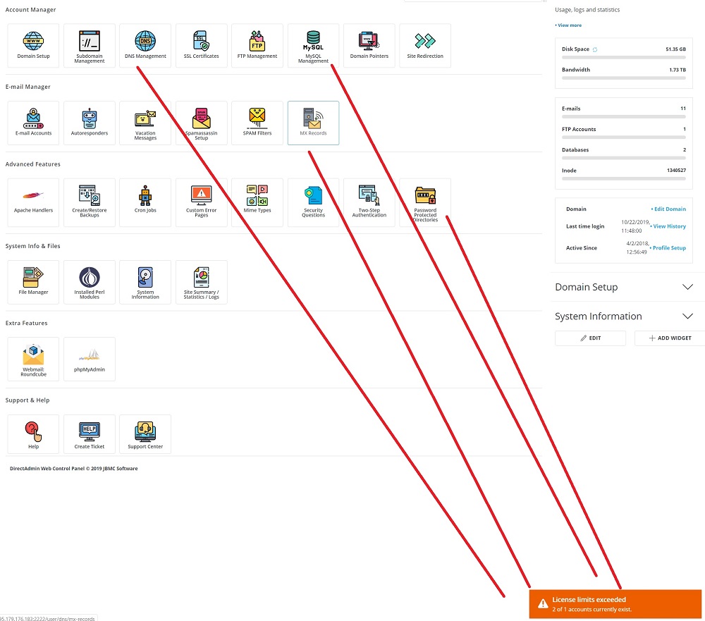

A ayberk Verified User Joined Apr 18, 2016 Messages 52 Oct 22, 2019 #1 Hello, We switched to personal license. However, I cannot access the MySQL page of the domains I added and some settings. Why could it be? I marked the places I couldn't enter. Last edited: Oct 22, 2019

smtalk Administrator Staff member Joined Aug 22, 2006 Messages 7,758 Location LT, EU Oct 22, 2019 #2 Personal license is for 1 account only (admin). If you'd like to have more than 1 account on the server, you'd need Lite license for this.

A ayberk Verified User Joined Apr 18, 2016 Messages 52 Oct 22, 2019 #3 Directadmin was installed with admin account when installed. I also installed a 55 GB backup to this account on the old server. What is the solution now? How to fix without damaging the site.

smtalk Administrator Staff member Joined Aug 22, 2006 Messages 7,758 Location LT, EU Oct 22, 2019 #5 You have admin+akilli users, With personal license you can only have 1 account (admin).
A ayberk Verified User Joined Apr 18, 2016 Messages 52 Oct 22, 2019 #6 smtalk said: You have admin+akilli users, With personal license you can only have 1 account (admin). Click to expand... Can I delete or merge my admin account?

A ayberk Verified User Joined Apr 18, 2016 Messages 52 Oct 22, 2019 #7 Can I move the 'akilli' account to it?

smtalk Administrator Staff member Joined Aug 22, 2006 Messages 7,758 Location LT, EU Oct 24, 2019 #9 There are scripts to move domain name and database to another account.
A ayberk Verified User Joined Apr 18, 2016 Messages 52 Oct 24, 2019 #10 Is this? cd /usr/local/directadmin/scripts ./move_domain.sh domain.com akilli admin
smtalk Administrator Staff member Joined Aug 22, 2006 Messages 7,758 Location LT, EU Oct 25, 2019 #11 Yes, for domain
