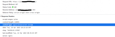

After installing a new server (with nginx + apache) and checking if IPv6 works i just noticed something weird.
in the /var/www/html/ we have placed a index.php that displayed the name of the requested domain.
If lookup the website via hostname there is no problem. But if i request it based on ip like https://[2a0b:xxx:xxx::xxx]/ it will not parse the PHP code and instead of displaying the page it will be downloaded (via octet-stream). The problem does not occur if we use only apache as a webserver.
Are there any other users that have nginx + apache that have this issue?
did you link IPV6 to IPV4 ? if not, try link it and see result.
Just test it with CURL
curl -k -6 https://[IPv6 Address]/redirect.php
Results in this output:
<?php
header("Location: http://".$_SERVER['HTTP_HOST'].":2222");
Via hostname
curl -k -6 https://<hostname>/redirect.php
Does the normal redirect
Via IPv4 there are no issues
