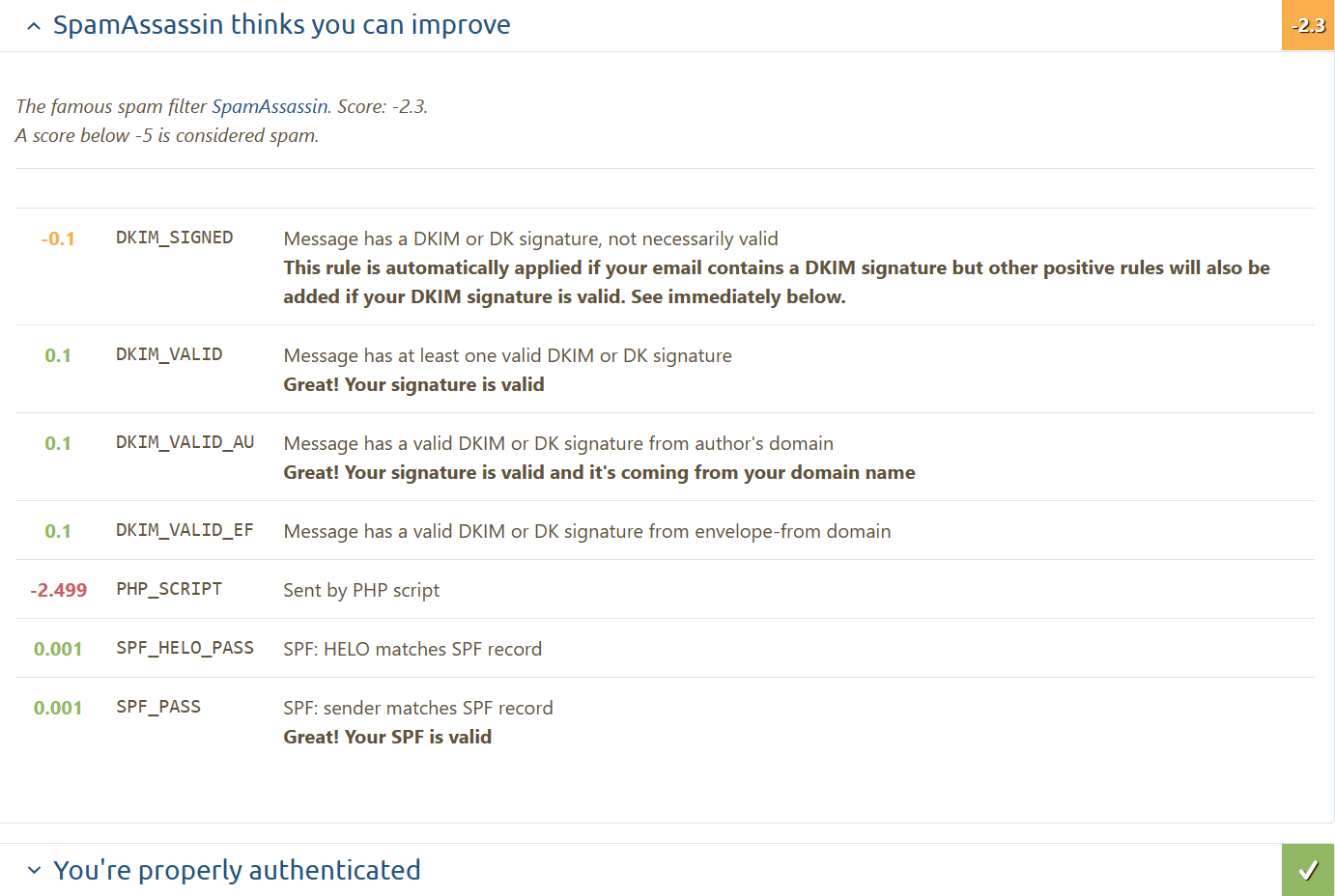

I checked and I already have spf / dkim for the hostname. I sent a test email on mail-tester and it gave 7.7/10 score. A 2.499 score was reduced because the mail was sent using a php script. Please check the attached screenshot.
How to better it ?

The score is good.
