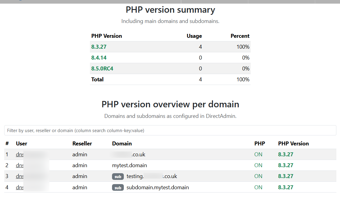

PHP version list plugin
Since I found it hard to find out which users / domains are still running on an older PHP version, I created a small plugin to list all the users / domains with the active PHP version.
You can find the code here or download the plugin file from here.
As far as I tested this myself it has the following requirements:
* DirectAdmin 1.55 and up
* PHP 5.6 and up
* Custombuild 2.0 (for the different PHP versions installation)
* DirectAdmin via https (httpsocket is working via ssl://...)
* Max 2 different installed PHP versions, via Custombuild 2.0
* Works best with the enhanced skin
