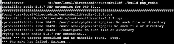

I need to install Php-Redis to enable Redis in the Litespeed Cache plugin. But I get this error during installation. What could be the problem?
I am using PRO PACK and Redis is installed. I just can't install Php-Redis.
It seems you're missing PHP 8.2 on the system, but you have it set in the options.conf file. Please build PHP first.
But our site is working right now. And it says 8.2 in the php selector section.
Still might be that php 8.2 is not installed properly or fully, because phpsize is missing and that should be present anyway.
Try rebuilding php 8.2 and see if that helps, check if the phpsize file is present after that. If yes, try the php-redis again.
