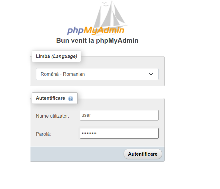

No, let me give you an example. If i create a user like this in PhpMyAdmin
And i try to log in with it like this
I will get this error
My question is, how do I prevent this, on a normal phpmyadmin install on a normal database this should work
I don't know, I never use it that way. Otherwise try using localhost instead of % for the host.

Aha... wel still... try using localhost instead of the default % for the host, maybe that already helps.
Also check for this line in /etc/my.cnf:
bind-address=127.0.0.1
and check your /etc/hosts file that it's bound correctly:
127.0.0.1 localhost.localdomain localhost
Then it should be possible to do it your way if the correct permissions are granted too.
Thank you, with localhost in the phpmyadmin the accounts can log in now but my question is, dosent this affect my servers ?
