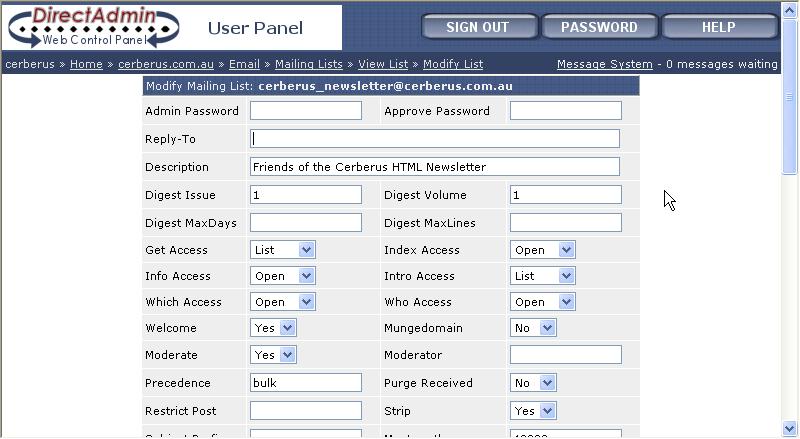

I wish to use Majordomo to run a moderated mailing list so that only the moderator can send e-mails to the list.
The control panel allows yes to be selected for Moderate. I am not sure what should be placed in the Moderator field.

With regard to placing the approval request in the headers, how is this done? Selecting "View - All headers" only displays the To, From, Cc, Bcc and Subject headers in Outlook Express. Is there another header that I have yet to discover?

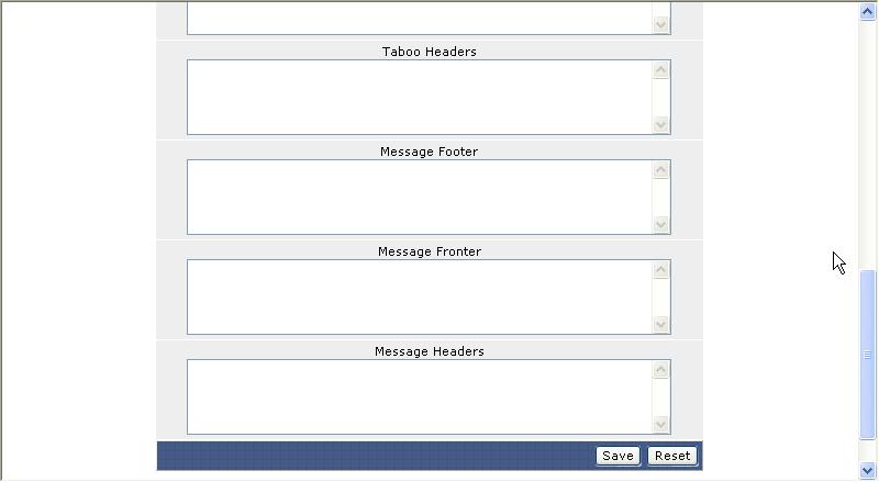

I have tried using the header field in the control panel which presumably would allow anyone to sent messages to the list. In any case this method does not work.

What do you mean by "header field in the control panel"?

Here's the documentation for message headers:
# message_headers [string_array] (undef) <resend,digest>
# These headers will be appended to the headers of the posted
# message. The text is expanded before being used. The following
# expansion tokens are defined: $LIST - the name of the current
# list, $SENDER - the sender as taken from the from line, $VERSION,
# the version of majordomo.
To me that means it won't work because the message never reaches that stage (posted) before it's bounced for approval.
