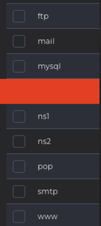

No, I didn’t create a subdomain, but I also didn’t create FTP, webmail, etc. — those are DNS records.
Even when I click on mysql.domain.tld in the dashboard, it never stays selected and it doesn’t generate the certificate.
The DNS record mysql is already present in the nameservers (NS) of each domain.
You might need to add it to the letsencrypt list in the/var/log/directadmin/confdirectadmin.conf file.
Normally this looks like:
letsencrypt_list=www:mail:ftp:pop:smtp
since mysql is only a DNS record and no real subdomain you might need to change it to this:
letsencrypt_list=www:mail:ftp:pop:smtp:mysql
and restart directadmin after making the change.

letsencrypt_list=www:mail:ftp:pop:smtp:mysql is already set in the configuration, but it still doesn’t generate the certificate.
