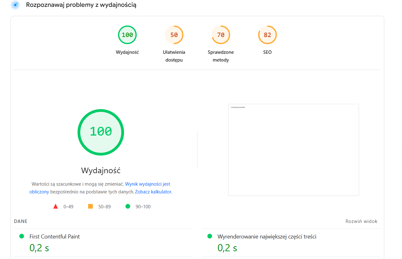

It looks like my suspicions were correct. After detaching the IP address from the server and entering it in the browser, it still shows “functioning normally.” It appears that someone has been using that address.
Refresh the page or use another browser to be sure it's not browser cache.
If not, then indeed somebody else is using the ip too and you have indeed to contact your data center.
If you removed the IP from Directadmin only, it might still exist on the server's network interface. If this is the case, then it's normally that you see the default page from /var/www/html/index.html which is shown to every domain/ip which have no a separate virtual host.
