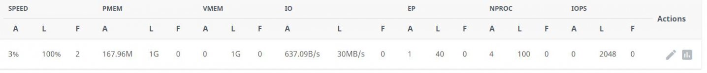

Hi, every time before logging into the system I get the following messages (attachment). Does anyone know what could be the reason?

It is always better to disable VMEM limits (set them to 0) in your system at all because they are deprecated and are causing unexpected issues.
