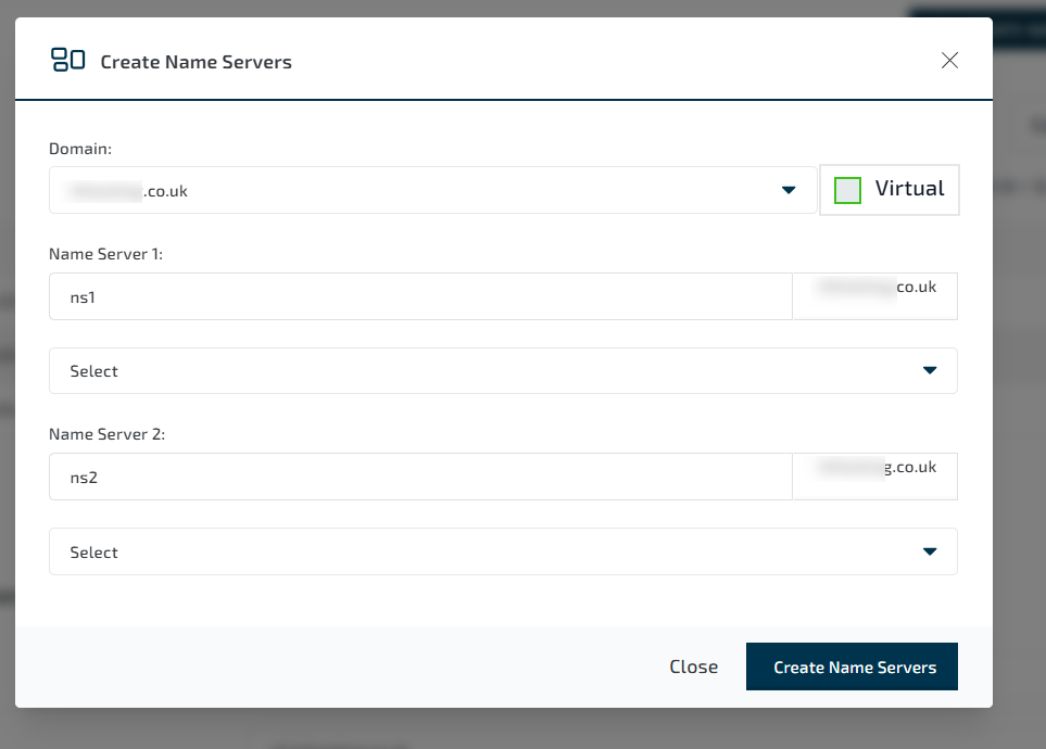

dns_ns.conf is a template that DA uses to create your DNS Zone files, so editing that won't end well if you're not sure what you're doing. the ns values you have set in the directadmin.conf are there so that DA knows what ns records to assign to each new domain.
Check under Admin -> Administrator settings -> Server and see if the servername and nameservers are correctly set.
Also check under Admin -> Nameservers to see if your nameservers are also as you require them. If not, you're able to create them there and DA should update itself.
Note: If you only have 1 IP assigned to your server, you won't get the dropdown "Select" boxes as shown above for the server IP. You'll have to create virtual nameservers.

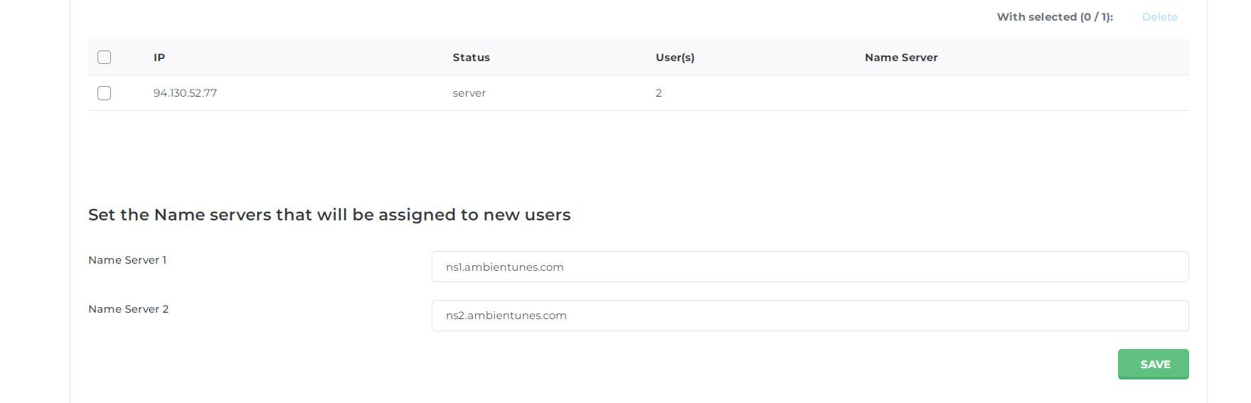

Thank you for you reply.
In Administrator Settings > Server there are:
Hostname: da.ambientunes.com / the same as PTR
NS1: ns1.ambientunes.com
NS2: ns2.ambientunes.com

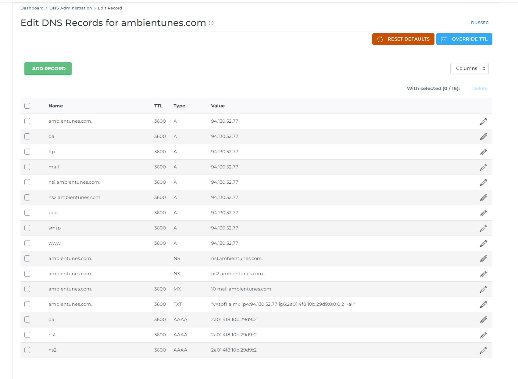

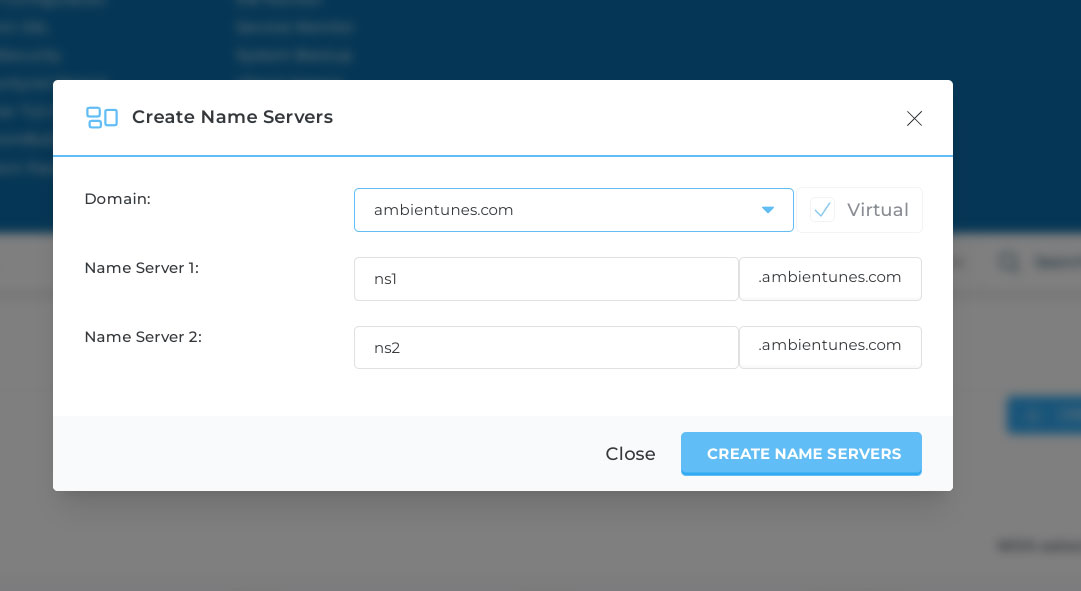

I did you you say, I created nameservers as below, but stil when I add new domain I get NS records:
test3.pl. NS ns1.da.ambientunes.com.
test3.pl. NS ns2.da.ambientunes.com.
I restarted directadmin, bind9 before adding new domain.

I added AAA records for NS1/2 as you said and now it works for domains on new accounts I create. On old account it still makes ns1.da.amb... but it's not a problem, I can live with it.
Thank you for your help 🙏 You've been much more helpful than GPT which only wasted my time.
