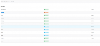

The last part of the log where the error is specified in the last line and the image file is attached
