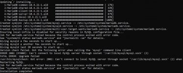

hello, experts, I am new to DirectAdmin I just installed DA a few days ago and I don't have any data and website, etc.
when I try to access PHPMyAdmin then I face the error "ERROR 1045 (28000): Access denied for user 'root'@'localhost' (using password: YES)"
then my Mariadb server stopped working and I try to reinstall it but I got an error...
ERROR 2002 (HY000): Can't connect to local MySQL server through socket '/var/lib/mysql/mysql.sock' (2)
FATAL ERROR: Upgrade failed
/usr/bin/mysqlcheck: Got error: 2002: Can't connect to local MySQL server through socket '/var/lib/mysql/mysql.sock' (2) when trying to connect
Restarting MySQL.
Job for mariadb.service failed because the control process exited with an error code.
See "systemctl status mariadb.service" and "journalctl -xe" for details.
sorry for my weak English and kindly help me ill be very thankful to you.
regards Zeeshan.
