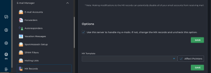

The adomain.com is existing in /etc/virtual/domains. Have have checked "Use this server to handle my emails." in DA already.

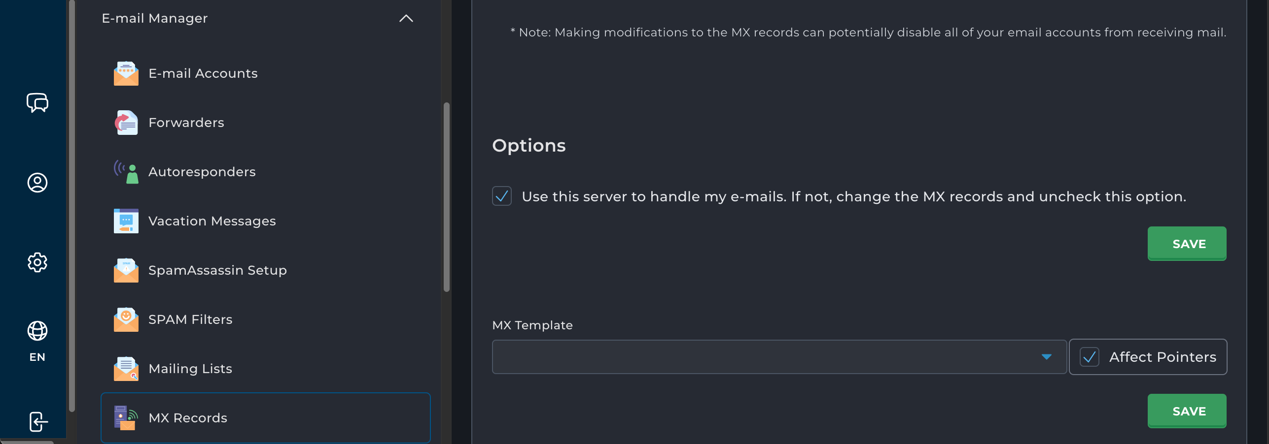

For us this was simply MX Records > "Use this server to handle my emails" for some reason not being ticked/enabled for a domain.
