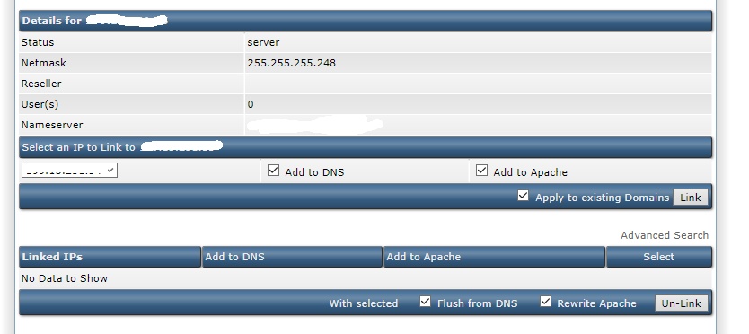

Hi zEitEr,
Yes, you're right.
I saw the second IP has [_] Add to DNS option checked.
I also saw that [_] Add to Apache option checked, do I have to uncheck too?
Please see the attachment.
Thank you for your help ...
