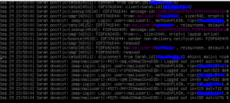

T thisyuvxx New member Joined Oct 17, 2020 Messages 2 Oct 18, 2020 #1 here is my mail.log, someone told me that the trouble is in my port. But i sure everything seems fine Attachments mail.log.PNG 44.9 KB · Views: 51 Port.PNG 4.2 KB · Views: 58
Richard G Verified User Joined Jul 6, 2008 Messages 14,888 Location Maastricht Oct 18, 2020 #2 Seems you're not using Directadmin as the maillog should not read postfix. DA does not use postfix. Check if port 25 is opened from outside (the internet). Also the mail.domain.id does not resolve everywhere yet.
