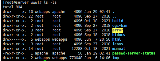

I checked the permissions and the result was as follows:
please help me.
When I double-click on the email, the email opens! But from the outside, it shows the same error!
Seems directory structure has different permissions. You're missing an execute flag.
Your /var/www should look like this:
dr-xr-x--x 10 webapps apache 4.0K 2022-03-12 02:15 www
The /var/www/html should be this:
drwxr-xr-x 5 root root 4.0K 2022-05-13 03:17 html
So that is chmod 755, not what you have.

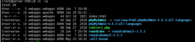

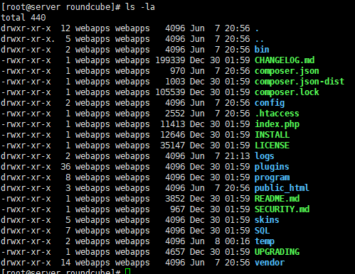

Can you do a ls -la inside the roundcube directory too?

I changed this like you:
[root@server var]# chmod 551 /var/www
[root@server var]# ls -lad /var/www
dr-xr-x--x. 10 webapps apache 4096 Jan 29 02:41 /var/www
this too
[root@server www]# chmod 755 /var/www/html
[root@server www]# ls -lad /var/www/html
drwxr-xr-x. 5 webapps webapps 4096 Jun  7 20:56 /var/www/html
But there is still a problem.
Still the same permission problem? That's odd.
Normally the directory itself should be owned by root, but that shouldn't be causing this issue.
Maybe it's something underneath, try this:
chown webapps:webapps /var/www/html/roundcube -R

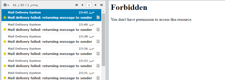

One thing I noticed today is that some emails receive this error while some emails do not.
Also, if the problem was from the access level, it should not have been seen by double-clicking on the email! This is while when you double-click on the email, the same email that does not have access will open!
See the following record screen:

Is exim even running correctly on the server? Because on one of the errors I've seen "MX or SRV record report no SMTP service".
If it's running correctly, then you might need to send in a support ticket.
