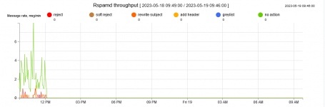

Hello, yesterday (about 12PM) I temporarily disabled ESF on a customer server to troubleshoot a problem with some legitimate emails rejected
Since then Rspamd service is still active and running but the dasboard's last activity data are those before the ESF removal (see enclosed screenshot)
Anyone has any idea of the reason?

Did you disabled or removed ESF ? if removed (my assumption is that ESF was mandatory to install rSpamd) you have to rebuild rspamd
Did you tried to rebuild rspamd ?

Yes but without ESF i see, maybe it is mandatory to run rSpamd
Yup , its confirmed then :)
