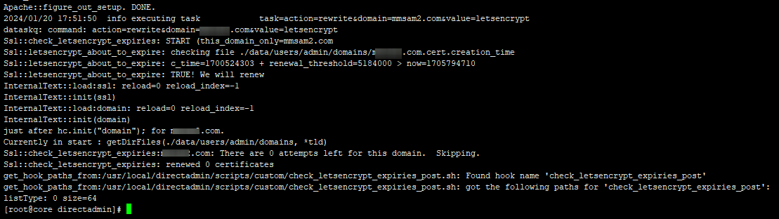

I performed this commands:
cd /usr/local/directadmin
echo `date +%s --date='61 days ago'` > "data/users/admin/domains/domain.com.cert.creation_time"
/usr/local/directadmin/directadmin taskq --run 'action=rewrite&value=letsencrypt&domain=domain.com' --debug 3100
Do you see any abnormal on that output?
Except for the fact that you have a customisation, not really. And it looks you have exceeded the attempts you can try at this moment.

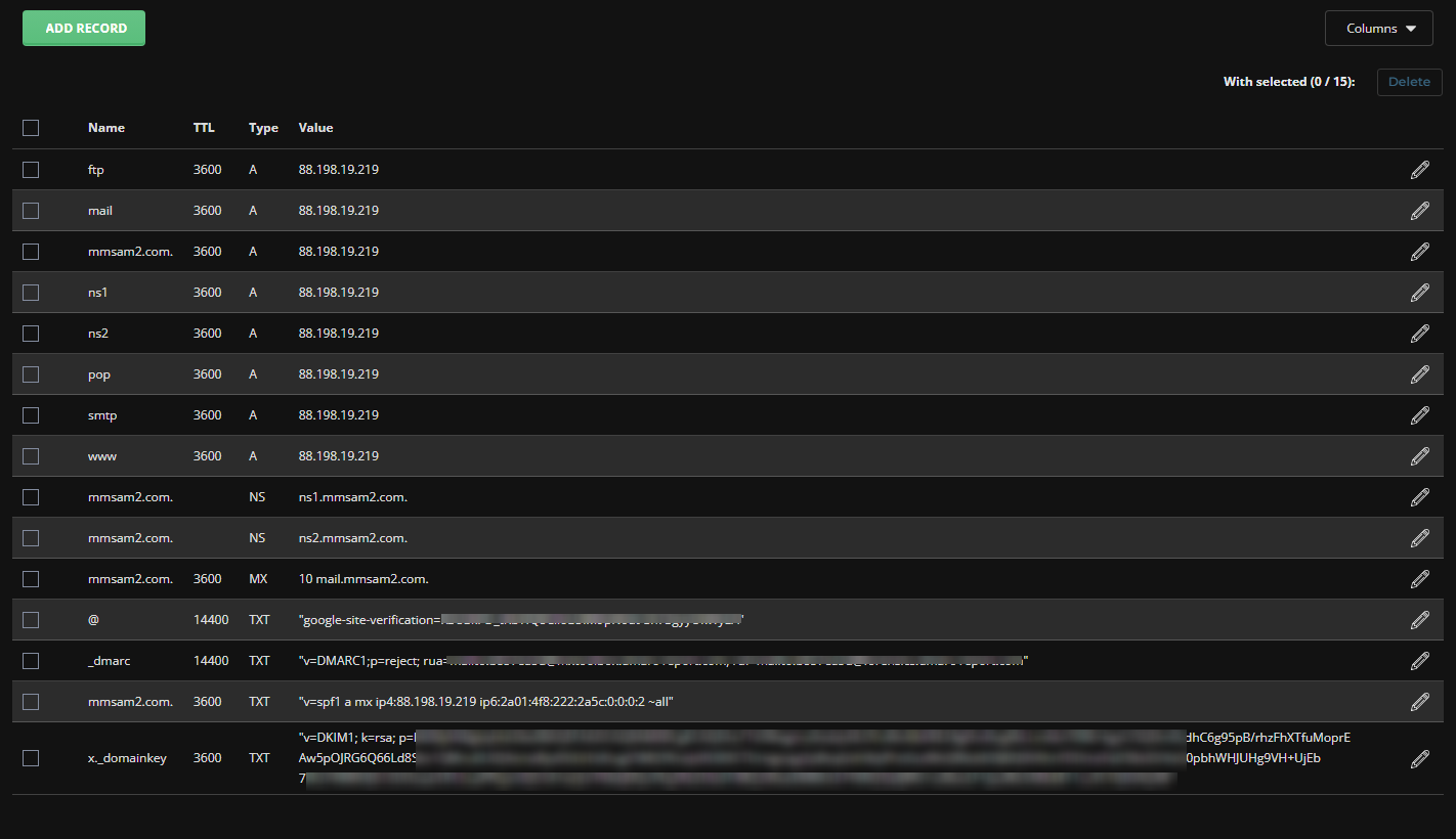

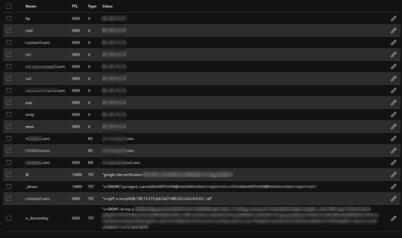

I haven't moved anything to my dns configuration and suddenly now intodns gives me those red errors with the nameservers
This is my zone configuration for my domain, it is the same as when i setup the server

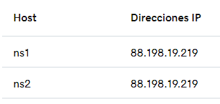

If i ping my ns1 and ns2 them respond correctly with the same ip.
I have double check my glue records and all seems fine
