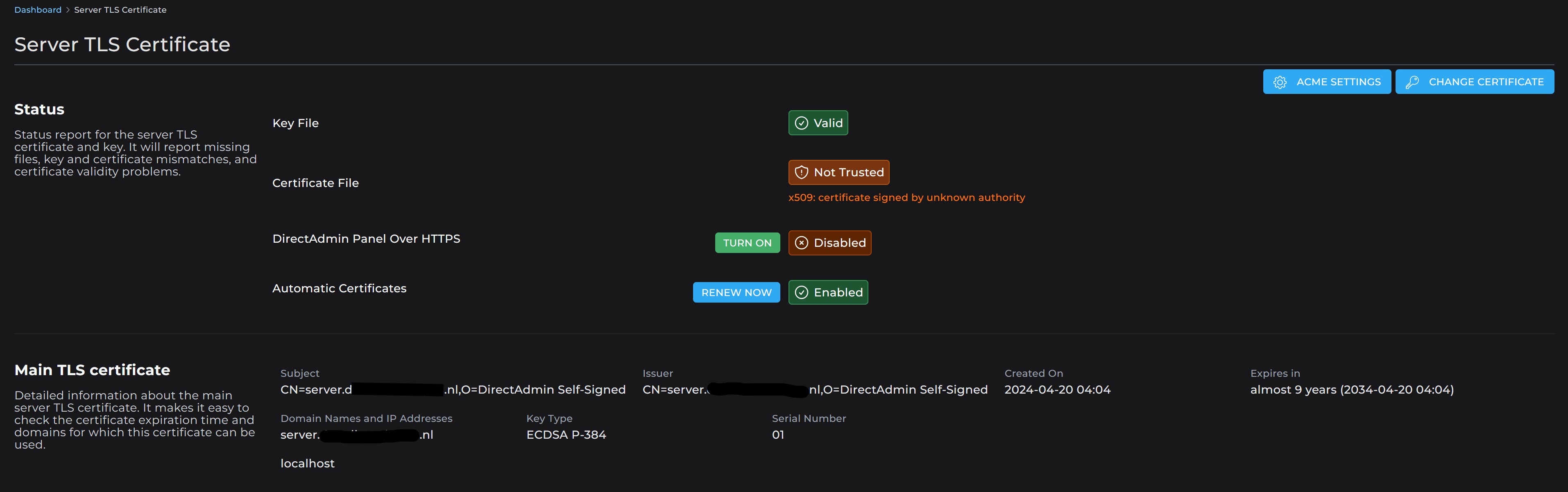

Since the recent Dovecot update, I'm having trouble sending mail with external mail programs. I've read the topics here on the forum and understand that plain text authentication is no longer supported. Fair enough, I can understand that and I would like to fix this the proper way (I was still using plain-text until now).
I thought that the first step is to setup a Server TLS Certificate, currently this is a self-signed certificate, which is not trusted. I'd like to fix that, but I am not getting further. If I request a new certificate, I get an error that 'automated certificate renewal' was not possible. I went through the steps to install/update ca in AlmaLinux, but these are already installed.
Anyone able to help? Do I need to complete any other steps after this in order to get secured authentication for SMTP to work?

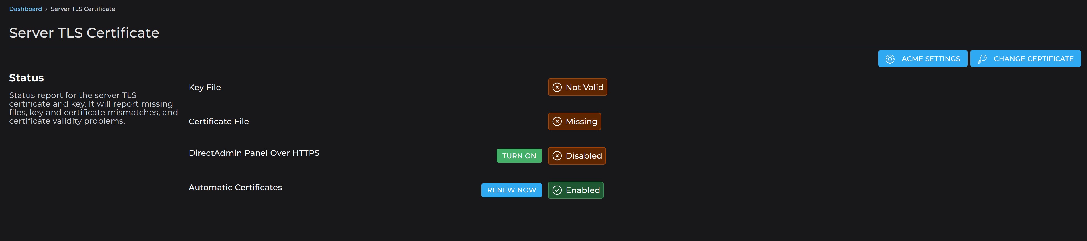

I ran the command from @zEitEr and this removed the existing self-signed certificate:
However, I am still unable to create a new certificate here: 'Error during automated certificate renewal for server.domain.nl'
