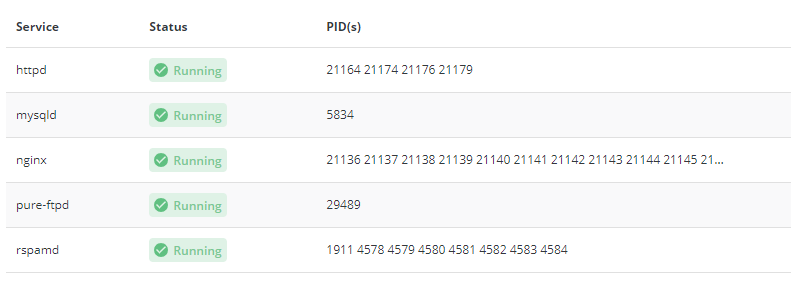

Hey guys in one of my DA servers the list of services have dissapeared many services and i cannot reach my domains by web
This one is DA servers that is working well
And this is another server that i cannot access by domain only by ip
This happened after i applyed updates throug custom build option in DA panel

Since CSF is running perfectly, you should put that service manually if you want to display it on UI. See this: https://www.directadmin.com/features.php?id=487
In my file, /usr/local/directadmin/data/admin/services.status I got this:
da-popb4smtp=ON
directadmin=ON
dovecot=ON
exim=ON
httpd=ON
mysqld=ON
named=OFF
nginx=ON
php-fpm74=ON
php-fpm80=ON
pure-ftpd=ON
sshd=ON
lfd=ON
You can add any services from the backend into this list (make sure the service exists, for example, if you use php-fpm80, you need to make sure php 8 has been installed).
Thanks i have edited the file and put this
da-popb4smtp=ON
directadmin=ON
dovecot=ON
exim=ON
httpd=ON
mysqld=ON
named=ON
pure-ftpd=ON
sshd=ON
rspamd=ON
nginx=ON
lfd=ON
that is what i have on my other DA server i made a copy/paste
Thanks now all seems to be normal
