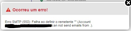

Hi everyone,
I’m having an intermittent issue when sending emails through Roundcube.
Sometimes, when sending a message, the following error pops up in the webmail interface:
An error occurred!
SMTP Error (550): Failed to set sender "" (Account ******@****** can not send emails from .)
Checking the Exim logs, I found entries like these:
2025-08-11 08:53:01 H=localhost (******) [127.0.0.1] rejected MAIL <>: Account ******@****** can not send emails from .
2025-08-11 10:20:38 H=localhost (******) [127.0.0.1] rejected MAIL <>: Account ******@****** can not send emails from .
2025-08-11 10:26:42 H=localhost (******) [127.0.0.1] rejected MAIL <>: Account ******@****** can not send emails from .
Additional notes:
- It happens to different users at different times (not always the same account).
- From what I can see, the sender field is empty ("") in these cases.
- The issue started in the last two weeks and happens to all users.
Has anyone experienced this before or knows what could be causing it?
Thanks in advance!
