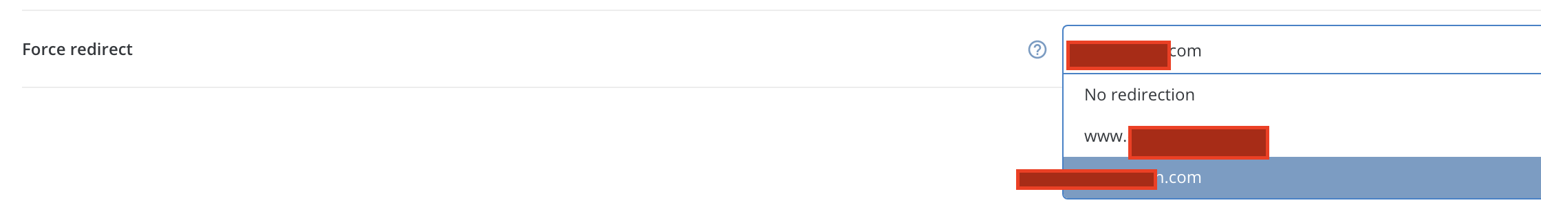

So you are not using the built-in functionality? in User > Domain Setup > click domain name option is force redirect.
