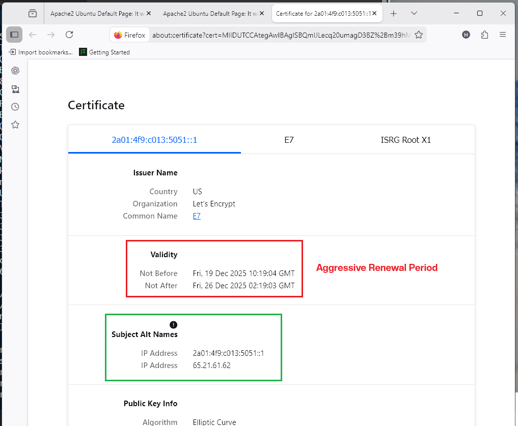

Certs are aggressively renewed, and expire after 7 days, so daily issuance is recommended (I guess as it's only supposed to be a temp fix)

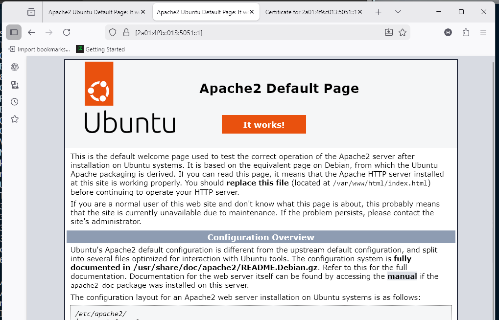

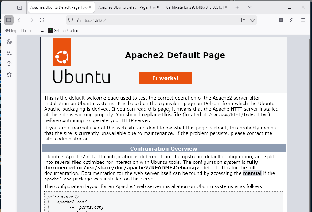

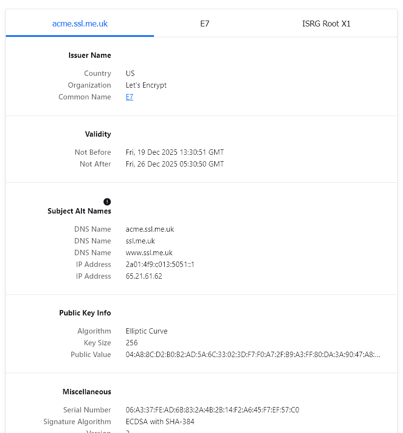

IPv4 and IPv6 supported, Pics incoming...!
Edit - Here's pics showing SSL on IPs
https://[2a01:4f9:c013:5051::1]
Certificate issuance
