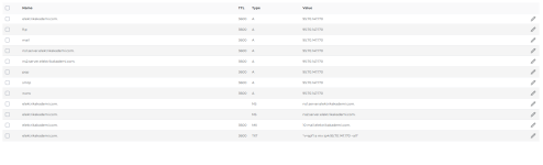

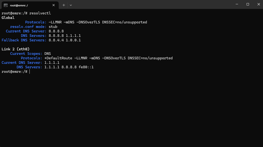

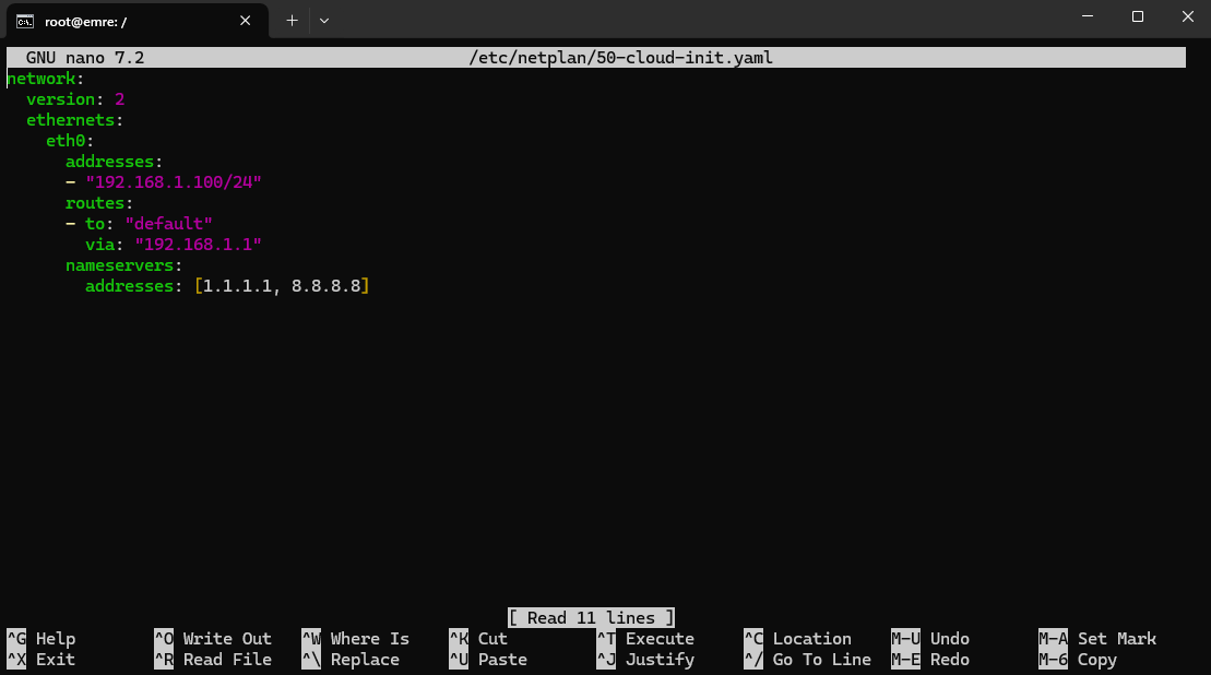

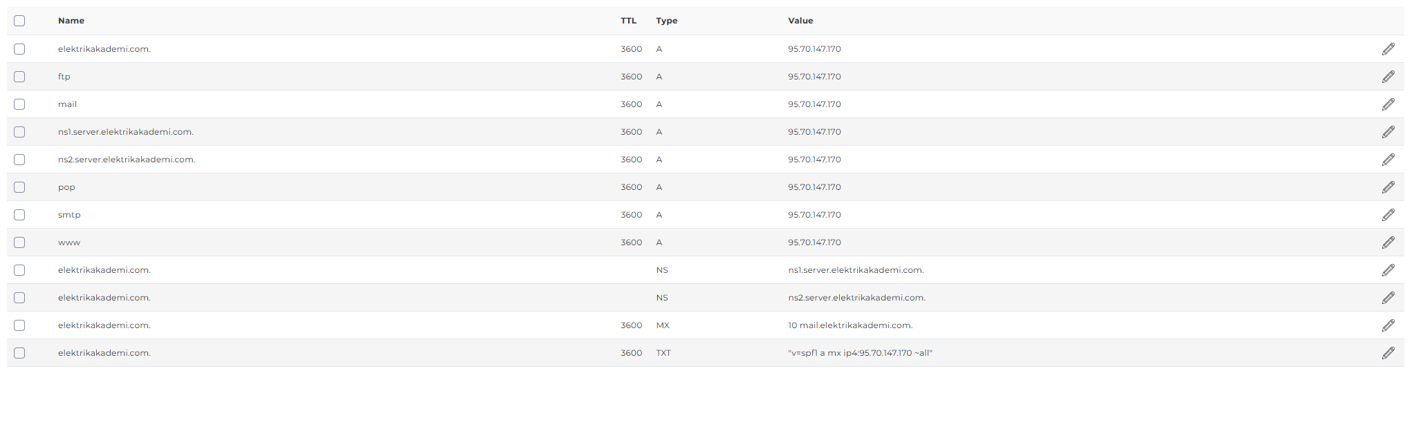

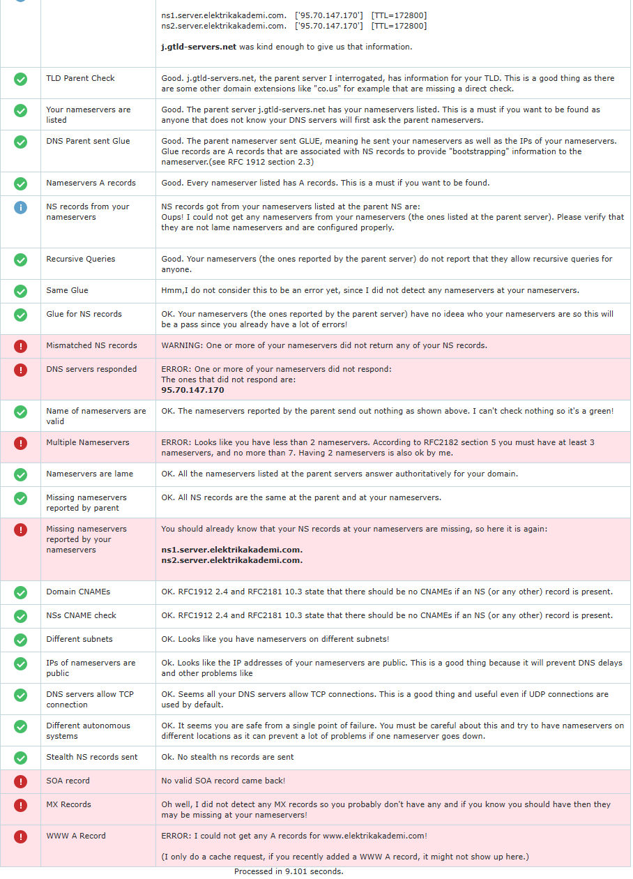

Hello, my port 53 is open and my websites on server are running but when I use intodns, I got some errors about DNS A records. I attached my intodns result, netplan yaml file, DNS records and resolvectl result. I don't know what to do. Can you help me?

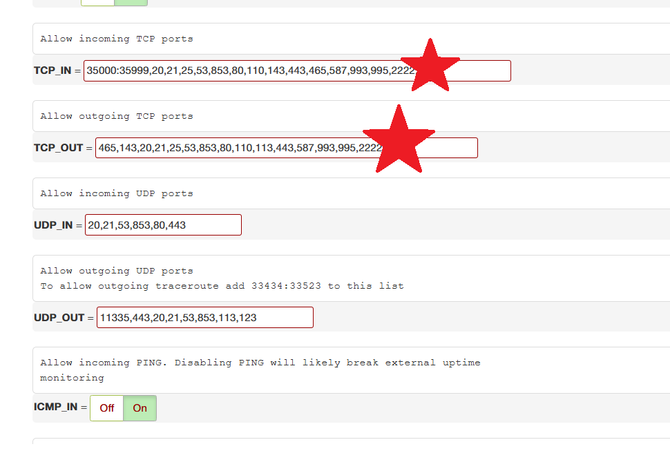

Your issue was already discussed here Incoming mail problem and LAN connection problem
Either your ISP is blocking TCP/UDP: 53 ports or your hardware is blocking it.
My ISP was blocking it but it is now open. My web site url works but into dns does not work. I can telnet port 53 and port checker web sites say port 53 is open. So where should I look at this stage do you think? I reinstalled DA without csf and nothing changed so csf is not the issue

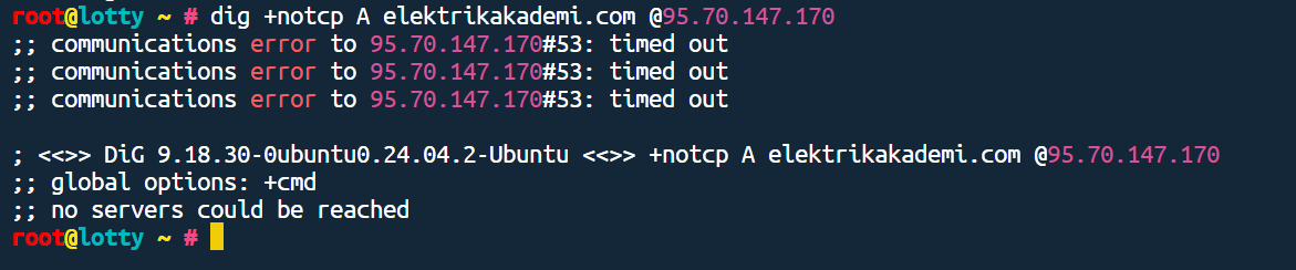

And still no DNS service is available on TCP:53
Bash:
$ nslookup elektrikakademi.com 95.70.147.170
;; connection timed out; no servers could be reached
even if TCP:53 port is opened:

Traffic to TCP:53 is not routed outside the world.
